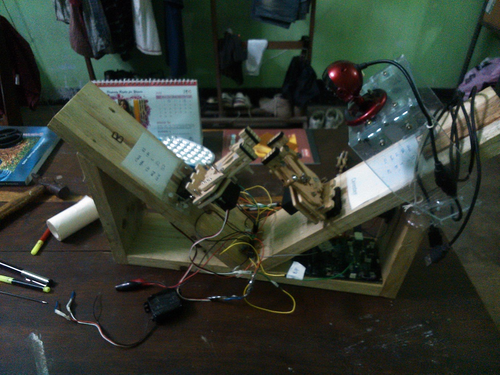

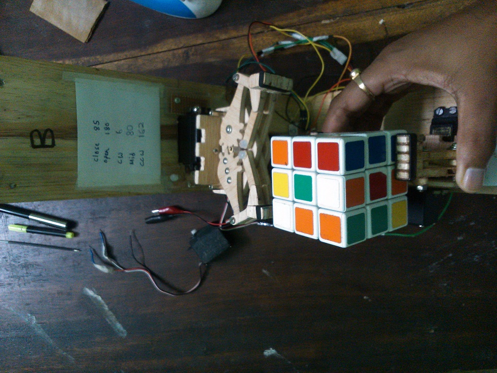

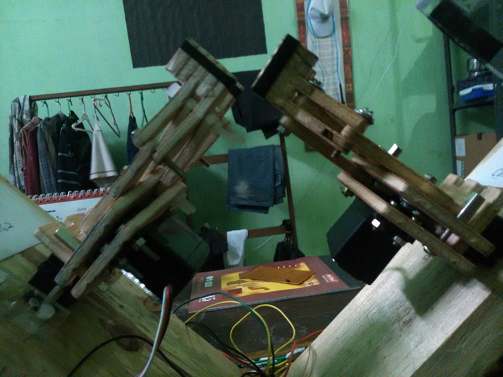

my project is almost done....but the cube falls off. This happens since the grippers are slightly off centered....i mean the grippers hold the cube off-centered. Me and my project partners are not being able to figure out how to correct this. I am going to give a last try tomorrow by shifting the grippers closer to each other almost so as they touch each other. Will that work out?
P.S:
Project submission is on 16th :frowning:
This is my setup
look at the distance between the grippers

Your wrist servo's are not mounted symetric, this may have an impact on alignment
Also make sure that boards are perpendicular
I enclose a pdf for the two boards (also available in eps, dxf, ai)
Important: dimensions are OK for a 57mm Rubik's cube
Let me know if it helps

Thanx a lot for that drawing. We aligned the grippers near-perfectly. Somehow.
Theres another problem now. We were using an indian clone called induinoX. I dont knw why but after scanning 4 sides of the cube. The message arduino not responding shows up in the console window.
I tried reducing the baud rate of serial communication in both cube mover.ino as well as in the python script to 9600 but it still doesnot work.
Probably not enough juice for the Arduino
try checking with a DVM
