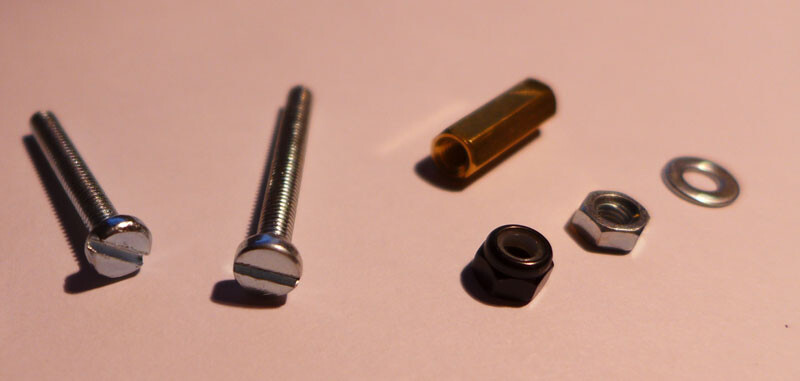

- Plywood 5mm (plexiglass, or PVC)
- 4 standard servo's
- M3 screws 10, 16, 20 and 24mm
- 3mm washers
- M3 nuts
- M3 Nylock nuts
- 14mm brass standoff spacers
For Imperial people, use 1/8" hardware

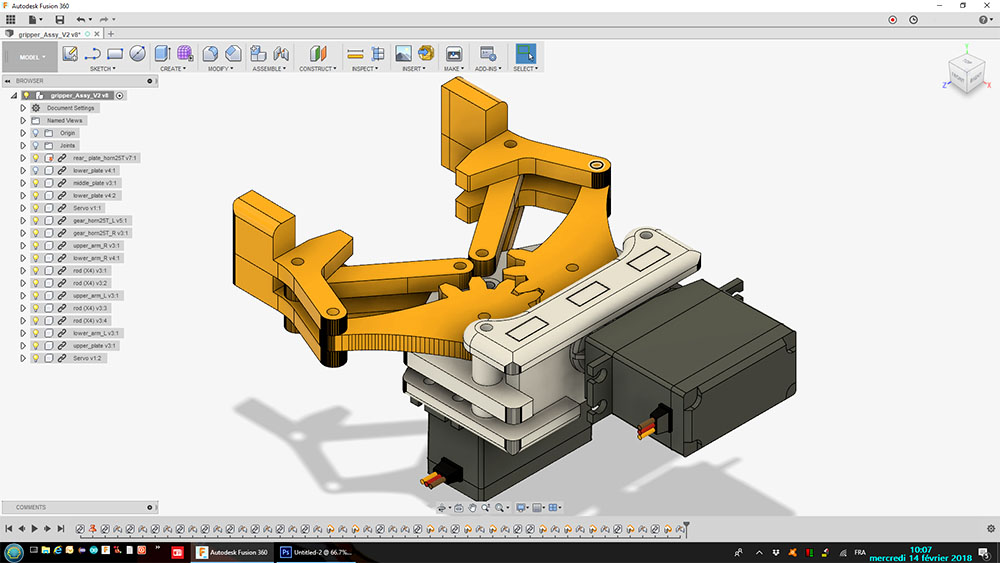

The grippers 3D printed version has been released on Thingiverse
This is the Fusion 360 final assembly, including the wrist servo:
exploded view video
the embedded horns are designed for Futaba 25 teeth spline geometry (Futaba/TowerPro/Orion/Savox/ProTekAce/Bluebird...)
I will release the two specific parts for Hitech servo's family (24T) if required

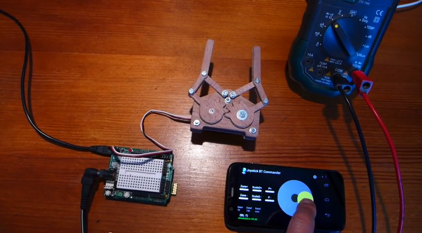

Testing:
Make sure you test your hardware according to post #6 and post #13

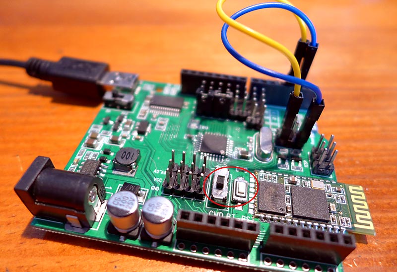

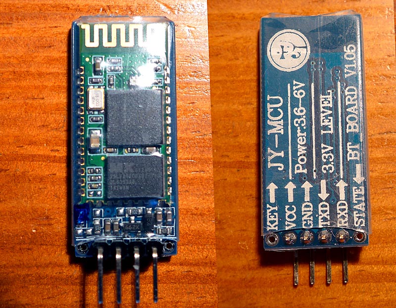

HC-05 or HC-06 Bluetooth board for smartphone/Arduino communication (3$ shipped on eBay)
or a very convenient Arduino/HC-05 combo

You should understand smartphone connection with HC-05 / HC-06 Bluetooth board
The best approach is to have Joystick BT Commander up and running (same protocol)
