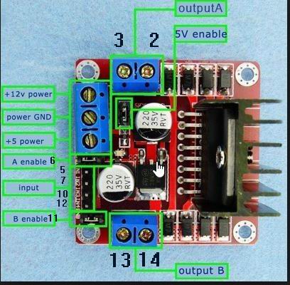

Below is a picture of a L298 module like mine and I have added the Pin numbers of the L298 chip to the modules input and output connectors.
If you see the Fig 7 on the datasheet it shows which Pin / Edge connectors you must join up to make it work in bridged mode.
:slight_smile: Perfect! That seems super easy! In the near future i will post here the results and pictures of the connections, in case someone needs it!
