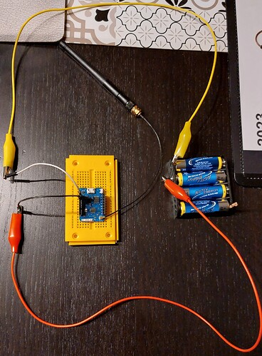

Like a lot of people before, I am using a D1 mini pro with a DHT22 temperature/humidity sensor shield.
As long as I power the D1 mini via USB, everything works fine.
Now I am trying to fit the boards into a case, add a battery pack for outdoor use.
Unfortunately, when I connect the D1 Mini with battery voltage, it won't boot, (blue led blinking, Tasmota connecting to Wifi).
I have a 4xAA battery pack giving 6.3 V. I tried it with 3xAA which gives 4,7V, to no avail.
When I connect with battery plus to the 5V pin and the battery minus with the GND pin, I can even measure 3.3 V at the 3V3 Pin, so the voltage regulator seems to work.
Any ideas, why it is not working?

no restraint in Tasmota found why it wouldn't use the 5Vin Pin ...

I didn't find a solution with the 5V Pin..
Now I have used a USB-cable to get the 5V into the D1Mini.
It was a bit tricky, because I had to rely on the cable having red as Vin(+) and black as GND,
but it worked.

change the protection diode with a zero-ohm resistance (bridge).
check here : WEmos minipro run from 3.3V - #2 by jim-p
