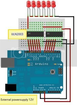

I think I ran into some serious trouble now, I got the letters soldered. I got everything connected. Yet when I apply 3V (using a resistor), or 5V without a resistor to pin 1(Base) (the one right under the little notch, right?) on the ULN2003, the Emmiter only gives me 0.6V at pin 16. I got pin 8 hooked up to ground and pin 9(Collector) hooked up to Vin (RAW on the Protoshield). I'm running the Arduino at 12V from an external power supply.
Strangly, all the lights do light up when I connect the directly to Vin and ground. I measured the power coming from Vin using this method and it gave me a reading of 14 V :o
It has to be something in the ULN2003 acting up.
Any ideas? I doubt they are corrupt or broken since this is the first time I turn them on, and they are all doing the same, I got 2 spares I never even took out of their little plastic container in which they were shipped.
Edit:
I made an schematic so you know how I wired it up.
Any clues what is wrong?
Edit again, I did a massive amount of research all day long and found out how this is used, and it works perfect!
