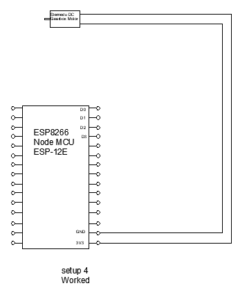

lastly I plugged the negative in the ground and the positive into the 3 volt source and it runs.

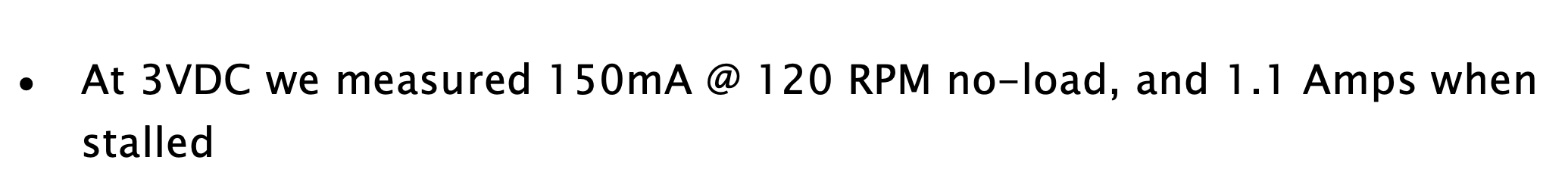

best I could find for motor
Microsoft Word - Document5 (digikey.com)

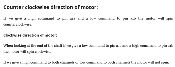

From the documents you posted...
This is how much current the motor draws... your 8266 can provide about 12mA ! ... so not even close if you are trying to drive it directly.
So you MUST use the driver. I suspect you need to connect the GND of the ESP and the GND of the driver.

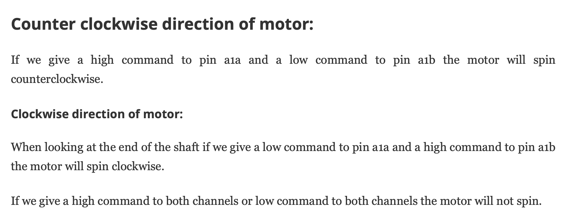

From an online tutorial ...
So in your original code...
  digitalWrite(D2, LOW);
  digitalWrite(D3, LOW);
...this will do nothing.
Thanks, I do have one question though. In my circuit diagram set up 4 that I just uploaded above, the motor did work. So what does that pin have more current than the other pins?
And I know you're not supposed to run it this way
You are running it from the ESP's power supply... so it passes through the onboard 3.3v voltage regulator (that has limited capacity). It can supply a lot more than the digital pins directly, and can be used for things that don't draw a lot of current, but generally for something like a motor you are much better off to power it completely separately.
