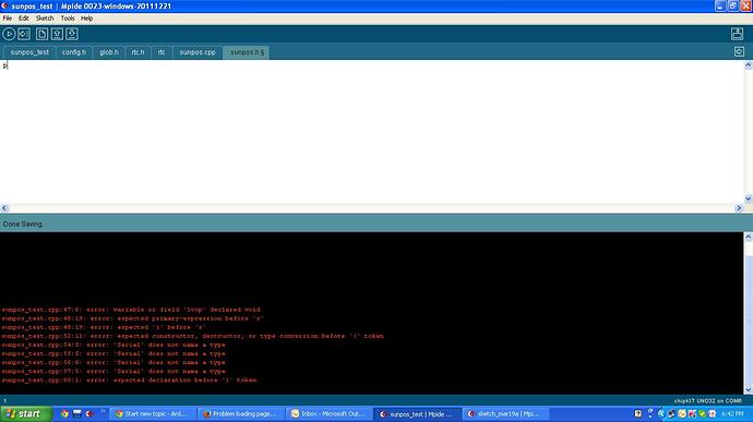

I wanted to run below code on Arduino platform. I am getting below error.
void loop{
  cSunCoordinates s;
    cTime t = {yy, mm, dd,h, m,s};
    cLocation l = {latitude,longitude};
    sunpos(t, l, &s);
    Serial.print("Zenith:");
    Serial.println(s.dZenithAngle);
     Serial.print("Azimuth:");
    Serial.println(s.dAzimuth);
Sunpos.cpp

void loop{
Should be:
void loop(){
That sun position algorithm appears to rely on 64 bit double precision floating point math, which the Arduino does not support (double is treated the same as float). At the very least the accuracy will be reduced and the algorithm might fail altogether. Be sure to check the output with some known test cases!

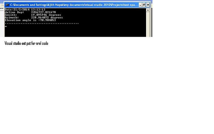

Here I am running Nrel c code on Arduino mega and Chipkit UNO32 Using MPIDE 0023 IDE .
Here i have attached code and expected output from Nrel. How to get Double Precision floating point values. I am using Windows XP , MPide V0023 .
In my code ,spa.cpp and spa_h changed DOuble to float. Still i am getting same result. Let me know how to solve this issue.
spa_tester.rar (9.99 KB)
