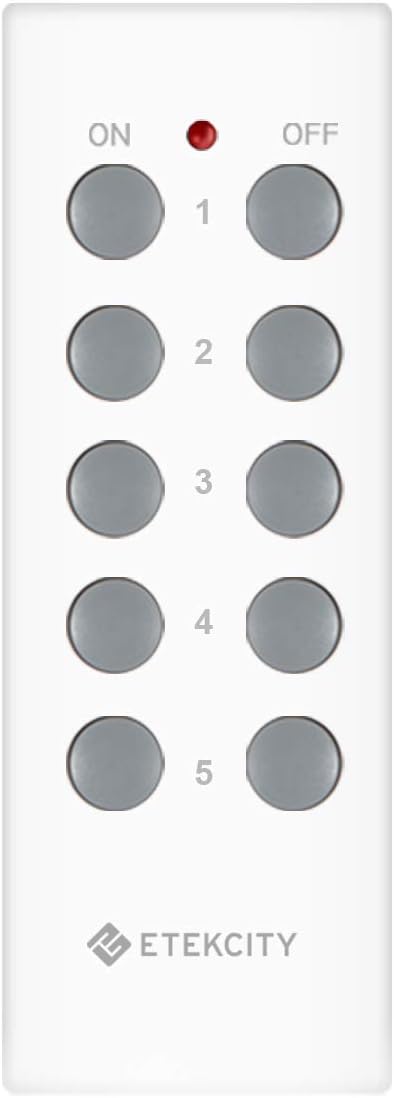

It seems with all libraries I have the same issue, no response. A defective unit? Unlikely, I exchanged for a new unit and experience the same issues. I've tried different arduionos I have as well. The remote? I've tried several 433mhz remotes to no avail, with different distances and press times. Here's what I'm using now:
Remotes

Would you expect something like this to work?
I've tried x10 remotes, which claim to be 433hz. I've also tried a fan remote that's also 433hz.
I would expect the remotes even with rolling code would still show up, just with different signals each time?
A 433.92MHz fan remote, or the remote you linked to, should work with a 433.92 receiver.
Beware, 315MHz is also used.
Did you try the examples from the IDE that came with the wireless libraries you have installed?
Leo..
None of those libraries will make any sense at all from a rolling code remote.
Simply because the remote is on 433 Mhz does not mean that it is decodable.
You have to know what the protocol that the remote uses, and then reverse engineer it.
Rcswitch will only decode PT2262 type protocols, so unless the keyfob uses one of these chips it wont be decoded.

It turns out it has been the remotes I've been trying. I bought a cheap 'wireless outlet rf kit' and the remote immediately showed up in my serial monitor.

Buying random remotes and expecting to be able to decode them is risky.
Rcswitch is designed primarily for operating remote control power outlets, and it requires
a remote with a particular encoder chip in it.
This link explains a bit more about how RCswitch works and the encoder chips it supports.
I cant see anything in the link for the remote that you are buying to indicate what encoder
chip it uses.
