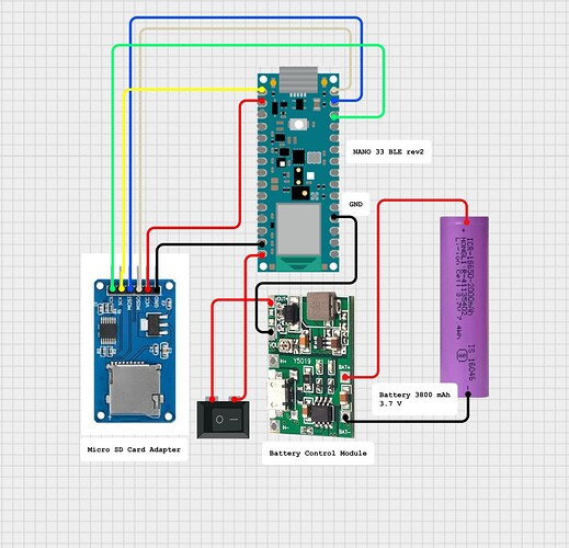

Schematic diagram Arduino Nano 33 BLE Rev2
This is a simple setup of Arduino Nano 33 BLE Rev2 with battery control module, a SD card adapter module and a battery
Please check the wiring I think I am messing up the ground, I'm new to this and is there a specific way the wires are to be structured
Thanks

Output to the left hmmm, here the outputs are mainly on the Arduino sooo lemme try rearranging

The SD module in your drawing is a 5V device so it won't work out.
Since you found a topic with one of my SD implementations you can see that I used one of those much smaller modules - they are 3V guys, no level-shifting hassle/s.

Except for what @runaway_pancake pointed out, the diagram in post #1 is fine.
