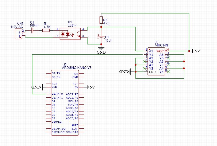

I had a few questions here about how to read some voltages but never made it work. Detecting 110V DC
Those voltages go from some 70V to 200V. As I haven't access to the system, my work was based on the data I get from the guy I am supposed to make this project. But it is not DC at all. It is AC, and it is as close to a 110V AC as possible, but still not exactly. I made a few measurements and get some 70V - 140V AC, but most readings were around 110V AC.
The problem is how to read variable voltages on a system which I should monitor, but not mess up in it at all. I should only take a two wires and see if there is voltage in it. Finally, I get some spare board of the system to see how they made it. It has been made with my initial approach, but with some additional components.
This is my 50 cents based on their design:
As you can see, they used a Schmitt trigger. I have never used this IC and have little or no experience with it. The other components are familiar. They used here 814 optocouplers, that is why I had bad readings, I used 817 optocouplers.
Question is, how to read it with Nano I attached? My guess is when there is a voltage, I will get some kind of LOW value. But, checking some solutions on the internet, I see some used it as an interrupt. That is why I tied it with the pin 2 on the Nano.
As I said in the topic I mentioned above, I don't have access to the system as much as I would have to. It is some kind of complicated.
I haven't made this project yet, came here first to check am I on the right track.
A PC817 does not have an internal fly-back diode, which in this circuit seems rather relevant.
The 7414 schmit trigger not-gate differs from a normal not-gate (7404) that with a schmitt trigger the transition from logic LOW to logic HIGH is at the exact same voltage as the transition from HIGH to LOW. This means that a squarish-wave will be more accurately timed square than when using a normal not-gate. In this circuit one can assume it to function the same as a 7404. Since you don't measure a wave but just continuous voltage.
Pin A1 on the 7414 will get a LOW value, that means that the nano will get a HIGH from pin Y1.

Does this mean that sketch DigitalReadSerial will print HIGH when there is a voltage at the end? If so, I am finally made a step forward. Just to assemble it and check it out with the system.

As OP has no idea how Schmitt Trigger works, it would be nice to tell him will this Schematic above with DigitalReadSerial says is there a voltage or not. That is the whole point of the topic and the question.
The Schematic is the same as the one on the board I had to monitor. Except, the Y1 line on that board goes to the onboard MCU. In my case, to Nano.

Yes pf course it is, i am so sorry for the confusion. Anyway in this circuit it doesn't really matter at all, Particularly with the 10uF capacitor, basically creating either a slow response ON or OFF, and a 7414 (or a 7404 for that matter) is a Hex NOT-gate.
@who_took_my_nick Oh that example, ah yes i have it. uh, yes, the Opto-coupler ground out the signal to A1 when there is power, the NOT-gate inverts the signal, so a logic HIGH is present at the Nano input pin D2.
In that sketch that should result in '1' being printed to the UART, which is the equivalent of 'HIGH', when there is power and '0' when there isn't.
