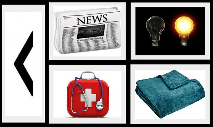

Now i am working with a single large image (800x480) which contains 5 smaller images which the user would press.
Would it be possible for you to give me the coordinates of the pictures which the users would have to press.
(i have attached the picture with this)
I have attached the image.
if (myTouch.dataAvailable()) {
  myTouch.read();
  x = myTouch.getX();
  y = myTouch.getY();
  if ((x > 19 && x < 155) && (y > 44 && y < 436)) {
    //button 'back';
  if ((x > 201 && x < 455) && (y > 21 && y < 212)) {
    //button 'news';
  if ((x > 201 && x < 455) && (y > 267 && y < 444)) {
    //button 'medicine';
  if ((x > 507 && x < 771) && (y > 26 && y < 208)) {
    //button 'light';
  if ((x > 507 && x < 771) && (y > 263 && y < 448)) {
    //button 'towel';
Regards,
Graham

UTFT_SdRaw myFiles(&myGLCD);
int x, y;
  while (!Serial) {
    ; // wait for serial port to connect. Needed for DUE & Leonardo only
  Serial.println(F("Initialising SD card..."));
  bool mysd = 0;
  // see if the card is present and can be initialized:
  while (!mysd) {
    if (!sd.begin(SD_CHIP_SELECT, SPI_FULL_SPEED)) {
      Serial.println(F("Card failed, or not present"));
      Serial.println(F("Retrying...."));
      mysd = 1;
      Serial.println(F("Card initialised."));
  Serial.println(F("Initialising LCD."));
  myGLCD.InitLCD();
  myGLCD.setFont(SmallFont);
  myTouch.InitTouch();
  myTouch.setPrecision(PREC_MEDIUM);
  Serial.println(F("LCD initialised."));
  myGLCD.clrScr();
  myFiles.load(0, 0, 800, 480, "lcd_2.raw", 2, 0);
    myTouch.read();
    x = myTouch.getX();
    y = myTouch.getY();
      //button 'back'
      Serial.println(F("back."));
      //button 'news'
      Serial.println(F("news."));
      Serial.println(F("medicine."));
      //button 'light';
      Serial.println(F("light."));
      //button 'towel';
      cout << F("Skip button detected (No GPS :( )\n");
Try something like this.
Regards,
Graham
