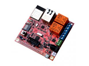

I am having trouble getting the SD library examples working on a ESP32-EVB board.
The example compiles but I see "Card Mount Failed" in the terminal.
I am not sure if the SD pinouts are correct, but I would not be able to change them as this is a single PCB:
Full Schematic

Is this board compatible with the SD_MMC library (the schematic is not clear to me)?
I am using a Sandisk Ultra PLUS 16g. I formatted it to 256Mb (both fat16 and fat32).
What else should I try?
