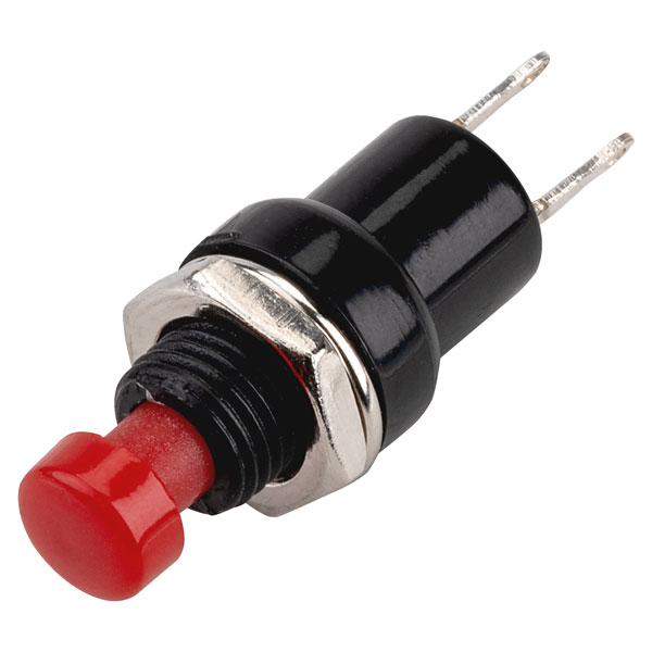

Of course it does matter. I image if it would have been a DC motor then a momentary switch might not matter as much as it might for an operating system.
