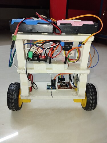

Self Balancing Robot
I am using Arduino Nano, MPU6050, l298n motor driver module and 6v dc geared motor to create a 2 wheel self balancing robot.
I am sharing the code below:

I found this code online as it is just edited the gyro offsets for mpu 6050 and tuned the PID values.
First Problem is the robot balances pretty well without the interrupt pin of mpu6050 is being connected to Arduino via digital pin 2. If I connect the interrupt pin the motors behaves abnormally. Sometimes they run at their full speed regardless of the pitch angle, or sometimes it balance for a few seconds and then motors stop completely.
But the code has defined interrupt pin. I am not sure if the interrupt is necessary and how the robot is working fine without this although it is mentioned in the code.
Second Problem is the robot occasionally tends to rotate left or right. I tried to put some values in 'Yaw PID'. But I am unable to figure out any patterns. If I put 1 to kP it becomes too much aggressive. I tried putting 0.01 it is same as putting 0. I am not sure how can I stop this abnormal rotation.
I have uploaded two short video on google drive. I am sharing the links below. I think this may provide better understanding of the situation.
1st video
2nd video
**I am using two separate battery set each consisting 2x 18650 lithium batteries. One for powering Arduino and another for powering motor driver. **
I am uploading the arduino code also.
Balanced_Robot_4.ino (6.5 KB)
Commendable job on the balancing robot.

Hey after a short break I'm again working on this project.
I have seen the codes of yours @Delta_G. It appears complicated to me as I am new in programming.
My queries:
  1. I have set the yaw pid values to 0. Then why the robot rotates randomly?
Another thing if I push the robot forward it moves forward in parallel direction. Same for the Backward. The robot only rotates randomly when no additional force is applied.
The right side motor tends to more liable for this abnormal rotation.
I have inversed the motor in the code but result is same.
In the starting it balances perfectly vertical. Few moments later the rotation appears as you can see on the video uploaded earlier. What is the reason for that?
Moreover, I have seen few codes for self balancing robot. They only contain One set of pid values. But my one has two sets of pid values named pitch pid and yaw pid. I am not sure what speciality it offers. I have set yaw pid to 0 but still the robot rotates.
Interestingly in the serial monitor it shows the yaw angle as I move the robot in the yaw direction. But whatever the yaw angle is the yaw pid is always showing 0, As it should be for 0 yaw pid values. Then why the robot rotates?
Another thing if I uncomment the serial debug option the robot fails to balance. I can only see the serial monitor when the motor powers are off.
  1. I think the motor noise cause the robot to randomly rotate. It randomly rotates 1 or 2 circles then slowly balance vertical for a few moment then again rotates, and it continues momentarily but it doesn't fall. I am thinking about omitting this issue for now.
Next is how to make the robot move forward and backward. I have searched on the forum but didn’t get any clear simple idea. I have read your thread but didn’t understand much.
All I know is, I need to bias the pid controller to tilt the robot towards the direction of movement.
But how do I do this?
  1. Finally, I believe (may be wrong though) my code has too much stuffs, like auto calibrate the mpu 6050. I am not using these for now.
May I request you all to go through my sketch and give me a simplified version deleting any unnecessary lines if they exists.
Please help thank you.
No, i found the code online as it is.
The purpose of the yaw controller is to control to whatever yaw / rotation angle you want. By setting the yaw loop tuning constants to zero you are effectively saying "don't control the yaw". So now any slight imbalances or irregularities in the floor may kick off a yawing movement as an offshoot of the pitch control movement, and there is nothing to prevent it.
You need to tune the yaw loop just like any other PID loop, with a combination of trial and error and rule of thumb loop tuning methods (just google it).
Thanks you were right. I revised my code and done a bit research. After few adjustments basically in the yaw pid values the robot balance itself parallelly. I am happy with it.
Next target is to move the robot forward and backward remotely.
To do so, I added nrf24l01 module and successfully blink an led remotely while balancing the robot. I have transmitted 3 potentiometer and one switch value and received all these value successfully.
Can anyone give me any links about how I can ensure that both balancing and movement controls are correctly applied and do not conflict with each other.
I have set the angle set point from -2.5 to 2.5 based on the value received through nrf module. the robot move forward and backward but it oscillates too much. after a few moments it falls. Even when the set point is 0 it oscillates. I tried to reduce pid values but then it is unable to balance.

Tried but doesn't work. It oscillates and gradually lose balance.
It appears that one of the data cable connections of the mpu 6050 was loose. Maybe it was the main problem. I also changed the pid values. Now forward and backward movement is good enough.
Next is to move the robot left and right. Can you please give me some hint ?
I did it. It works. Thank you everyone for your patience and support.
Sharing the code and Video below:

#define PID_PITCH_KP 58
#define PID_PITCH_KI 400
#define PID_PITCH_KD 1.1
#define PID_YAW_KP 0.6
#define PID_YAW_KI 0.3
#define PID_YAW_KD 0.01
PID pitchPID(&pitchGyroAngle, &pitchPIDOutput, &setpointPitchAngle, PID_PITCH_KP, PID_PITCH_KI, PID_PITCH_KD, DIRECT);
PID yawPID(&yawGyroRate, &yawPIDOutput, &setpointYawRate, PID_YAW_KP, PID_YAW_KI, PID_YAW_KD, DIRECT);
int enableMotor2 = 10;
int motor2Pin1 = 7;
int motor2Pin2 = 8;
int motor1Pin1 = 6;
int motor1Pin2 = 5;
int enableMotor1 = 9;
void setupPID() {
    pitchPID.SetOutputLimits(PID_MIN_LIMIT, PID_MAX_LIMIT);
    pitchPID.SetMode(AUTOMATIC);
    pitchPID.SetSampleTime(PID_SAMPLE_TIME_IN_MILLI);
    yawPID.SetOutputLimits(PID_MIN_LIMIT, PID_MAX_LIMIT);
    yawPID.SetMode(AUTOMATIC);
    yawPID.SetSampleTime(PID_SAMPLE_TIME_IN_MILLI);
void setupMotors() {
    pinMode(enableMotor1, OUTPUT);
    pinMode(motor1Pin1, OUTPUT);
    pinMode(motor1Pin2, OUTPUT);
    pinMode(enableMotor2, OUTPUT);
    pinMode(motor2Pin1, OUTPUT);
    pinMode(motor2Pin2, OUTPUT);
    pinMode(A0, OUTPUT);
    rotateMotor(0, 0);  // Initialize motors to stop
void setupMPU() {
    #if I2CDEV_IMPLEMENTATION == I2CDEV_ARDUINO_WIRE
        Wire.begin();
        Wire.setClock(400000); // 400kHz I2C clock. Comment this line if having compilation difficulties
    #elif I2CDEV_IMPLEMENTATION == I2CDEV_BUILTIN_FASTWIRE
        Fastwire::setup(400, true);
    #endif
    mpu.initialize();
    devStatus = mpu.dmpInitialize();
    // Use predefined offsets instead of auto-calibration
    mpu.setXAccelOffset(-429);
    mpu.setYAccelOffset(-1701);
    mpu.setZAccelOffset(1161);
    mpu.setXGyroOffset(-5);
    mpu.setYGyroOffset(-6);
    mpu.setZGyroOffset(15);
    if (devStatus == 0) {
        mpu.setDMPEnabled(true);
        dmpReady = true;
        packetSize = mpu.dmpGetFIFOPacketSize();
        Serial.print(F("DMP Initialization failed (code "));
        Serial.print(devStatus);
        Serial.println(F(")"));
    radio.begin();
    radio.openReadingPipe(0, address);
    radio.setPALevel(RF24_PA_MAX);
    radio.setDataRate(RF24_250KBPS);
    radio.setChannel(124);
    radio.startListening();
    setupMotors();
    setupMPU();
    setupPID();
    static bool radioWasAvailable = false; // Track the previous state of the radio
    if (radio.available()) {
        // Radio is available
        radio.read(&receiverdata, sizeof(packetdata));
        digitalWrite(A0, receiverdata.swtch1);
        // Update setpointPitchAngle based on receiverdata.pot1
        if (receiverdata.pot1 == 127) {
            setpointPitchAngle = 0; // Center position
            // Map pot1 (0-255) to the range -2.5 to 2.5
            setpointPitchAngle = map(receiverdata.pot1, 0, 253, -2500, 2500) / 1000.0;
        radioWasAvailable = true; // Mark radio as available
        // Radio is not available
        if (radioWasAvailable) {
            setpointPitchAngle = 0; // Set to 0 when radio becomes unavailable
            radioWasAvailable = false; // Mark radio as unavailable
    // Print the current state for debugging
    Serial.print("Radio Available: ");
    Serial.println(radioWasAvailable ? "Yes" : "No");
    Serial.print("Setpoint Pitch Angle: ");
    Serial.println(setpointPitchAngle);
    if (!dmpReady) return;
    fifoCount = mpu.getFIFOCount();
    if (fifoCount >= packetSize) {
        // Read a packet from the FIFO
        mpu.getFIFOBytes(fifoBuffer, packetSize);
        // Process the data
        mpu.dmpGetQuaternion(&q, fifoBuffer);
        mpu.dmpGetGravity(&gravity, &q);
        mpu.dmpGetYawPitchRoll(ypr, &q, &gravity);
        mpu.dmpGetGyro(&gy, fifoBuffer);
        pitchGyroAngle = ypr[1] * 180 / M_PI;  // angle in degrees
        pitchPID.Compute();
        int motorAdjustment = 0;  // Default adjustment value
        if (radioWasAvailable && receiverdata.pot2 == 127) {
            // If pot2 is centered and radio data is available, use the yaw PID for motor control
            yawGyroRate = gy.z;  // rotation rate in degrees per second
            yawPID.Compute();
        } else if (radioWasAvailable) {
            // Disable yaw PID by setting yawPIDOutput to 0 when radio data is available and pot2 is not 127
            yawPIDOutput = 0;
            // Map receiverdata.pot2 (0-255) to (-75, 75) for manual adjustment
            motorAdjustment = map(receiverdata.pot2, 0, 255, -100, 100);
            // When radio data is unavailable, keep yaw PID active
            yawGyroRate = gy.z;
            yawPID.Compute();
        // Calculate the motor speeds
        int motorSpeed1 = pitchPIDOutput + yawPIDOutput + motorAdjustment;
        int motorSpeed2 = pitchPIDOutput - yawPIDOutput - motorAdjustment;
        // Constrain motor speeds to ensure they stay within the valid range
        motorSpeed1 = constrain(motorSpeed1, -255, 255);
        motorSpeed2 = constrain(motorSpeed2, -255, 255);
        rotateMotor(motorSpeed1, motorSpeed2);
        #ifdef PRINT_DEBUG_BUILD
            Serial.print("Yaw Rate: ");
            Serial.println(yawGyroRate);
            Serial.print("Yaw PID Output: ");
            Serial.println(yawPIDOutput);
            Serial.print("Pitch Angle: ");
            Serial.println(pitchGyroAngle);
            Serial.print("Pitch PID Output: ");
            Serial.println(pitchPIDOutput);
            Serial.print("Motor Adjustment: ");
            Serial.println(motorAdjustment);
            Serial.print("Motor Speed 1: ");
            Serial.println(motorSpeed1);
            Serial.print("Motor Speed 2: ");
            Serial.println(motorSpeed2);
        #endif
void rotateMotor(int speed1, int speed2) {
    if (speed1 < 0) {
        digitalWrite(motor1Pin1, HIGH);
        digitalWrite(motor1Pin2, LOW);
        digitalWrite(motor1Pin1, LOW);
        digitalWrite(motor1Pin2, HIGH);
    if (speed2 < 0) {
        digitalWrite(motor2Pin1, HIGH);
        digitalWrite(motor2Pin2, LOW);
        digitalWrite(motor2Pin1, LOW);
        digitalWrite(motor2Pin2, HIGH);
    // Ensure that the minimum speed is respected, but constrain within valid range
    speed1 = constrain(abs(speed1) + MIN_ABSOLUTE_SPEED, MIN_ABSOLUTE_SPEED, 255);
    speed2 = constrain(abs(speed2) + MIN_ABSOLUTE_SPEED, MIN_ABSOLUTE_SPEED, 255);
    analogWrite(enableMotor1, speed1);
    analogWrite(enableMotor2, speed2);
Transmitter Side
#include <SPI.h>
#include <nRF24L01.h>
#include <RF24.h>
//create an RF24 object
RF24 radio(7, 8);  // CE, CSN
//address through which two modules communicate.
const byte address[6] = "ABCDE";
struct packetdata
  byte pot1;
  byte pot2;
  byte pot3;
  byte swtch1;
packetdata data;
  radio.begin();
  //set the address
  radio.openWritingPipe(address);
  //Set module as transmitter
  radio.stopListening();
  pinMode(A0,INPUT);
  pinMode(A1,INPUT);
  pinMode(A3,INPUT);
  pinMode(A2,INPUT_PULLUP);
int mapAndAdjustJoystickDeadBandValues(int value, bool reverse)
  if (value >= 540)
    value = map(value, 540, 1024, 127, 255);
  else if (value <= 450)
    value = map(value, 450, 0, 127, 0);
    value = 127;
  if (reverse)
    value = 254 - value;
  return value;
  data.pot1         = mapAndAdjustJoystickDeadBandValues(analogRead(A0), true);
  data.pot2         = mapAndAdjustJoystickDeadBandValues(analogRead(A1), false);
  Serial.print("The value of pot2 :");
  Serial.println(data.pot2);
  //data.pot3           = map(analogRead(A3), 0, 1023, 0, 254);
  data.swtch1         =!digitalRead(A2);
  radio.write(&data, sizeof(packetdata));
Remote Controlled self balancing robot
