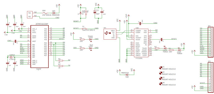

Hello,
I have run Nick Gammons Fuse Calculator.
I have run Nicks Board Programmer and after it fails, it stops responding at all.
@Nick:
I thought my chip is dead and I changed it with new one.
It opens programming mode and after a while it aborts.
Problems come after I run the Board Programmer with a try to write a bootloader (Uno).
Posible Errors (new):
New Fuse settings during the attempt to write the bootloader.
Maybe setup to external Crystal-and mine is defective.
Can somebody please take a look on the Shema if I made a mistake somewhere?
Nick, any Ideas?
Thanks
Nothing jumps out at me. Should post the layout too.
Have you ohm'ed it out to check for shorts? Check all adjacent pins, particularly those used for programming, ensuring that they're not shorted to ground, supply, or eachother. Shorts underneath a capacitor are fairly common.
The schematic shows the "reset capacitor" between the FT232 and GND. That's wrong.
Your 328 pinout looks wrong; RX and TX are on PORTD, not PORTC.
(However, Neither of those explains your immediate problem.)
DTR should go thru the cap then connect to Reset.
Ditto onPD0, PD1, those are the D0/D1 Rx/Tx pins (I might have them swapped).
Think you also need to connect Test on Ft232 to Gnd, check the datasheet.
Thank You very much.
I changed the DTR output to Reset.
Corrected the RX/TX Ports and connected Test to GND.
I checked the PCB Layout manually.
The only difference between my standard design is the "missing" C5 Cap.
On this layout I relocated C5 far away from Pin18.
Usually I put it near the µC Pin.
Can this cause my Problems?
I'll fix this. If it works I'll make new PCB and post the results.
Thanks again,
Mav.
Hello,
The new Circuit.
Programming over ISP working now. Not over USB.

As I was not sure why my previuos Boards doesnt responds after I run Nicks Programmer,
this time I burn the (Nano) Bootloader directly with my Uno over the IDE.
When I plug in the Board, there is a Handshake between the Computer and the Nano.
The serial Chip get 4,75V over USB.
Is this enought?
On Abort I get this:
avrdude: stk500_getsync() attempt 1 of 10: not in sync: resp=0x28
Regards,
Mav

Sounds like on the 328P design you do not have DTR from FTDI going thru a 0.1uF cap to the Reset pin, with a 10K pullup on the Reset pin to +5. That would allow the PC software to reset the 328P chip. Hence the need to press reset manually to get the bootloader started.
EDIT: OK, I misunderstood something.
I'll add this R10K to the Reset PIN of the FTDI.
@CrossRoads: OK, to pull-up the reset on the FT232 doenst help.
Do You know if external FT232 needs manual Reset too?
The 10K pullup needs to be the 328P reset pin. See attached.
I have got this one in all my Setups, like You.
It's strange that I get the same problem on 2 different Boards (328P and 32U4)
