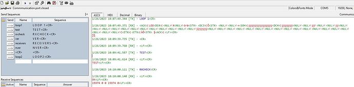

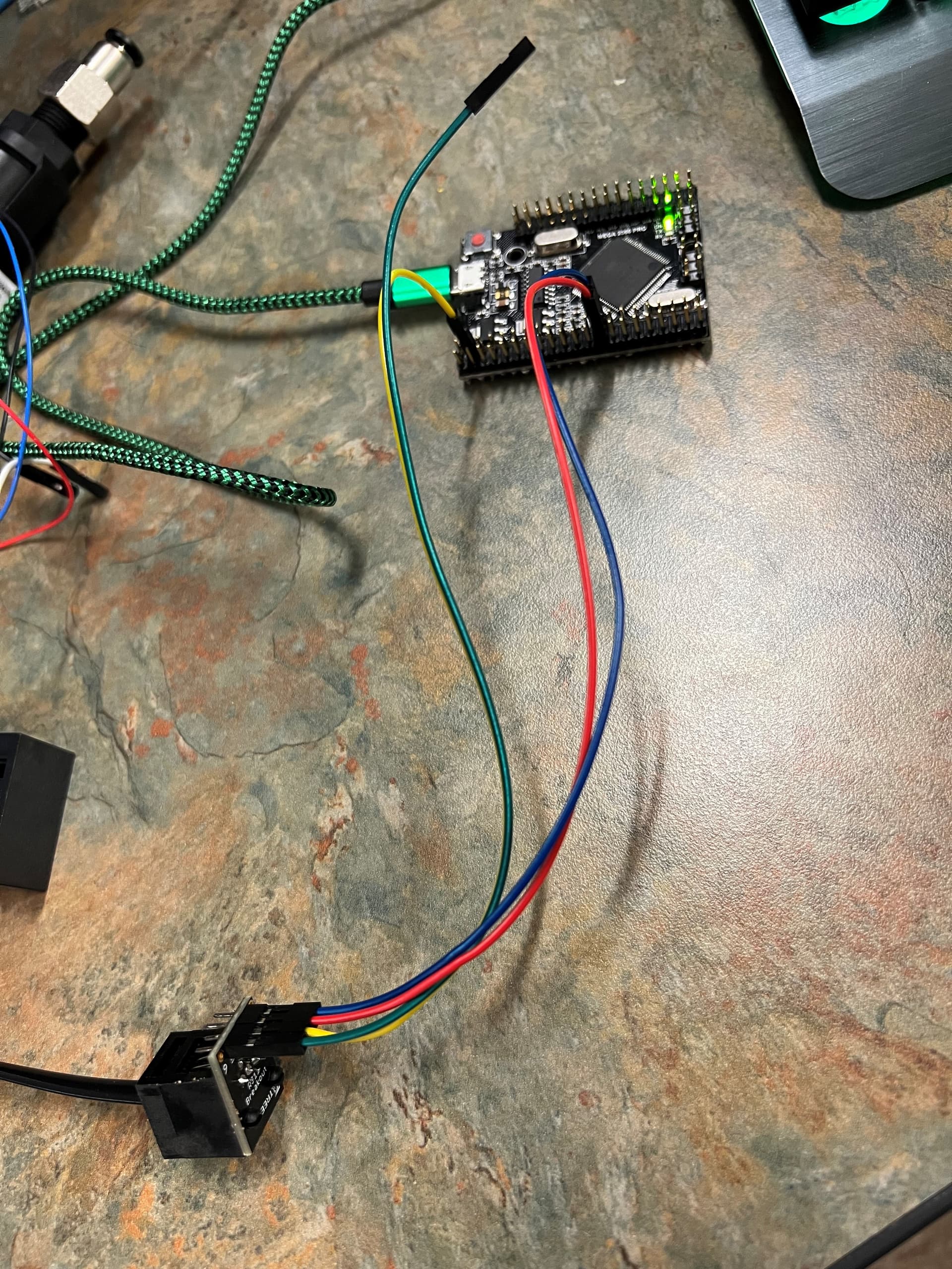

I am new here and to arduino. I am using an ATMEGA2560 clone. I am using Serial3(pins 14,15). Using windows 11. I have uploaded my setup shows it is transmitting, snip of docklight as proof that data is sending, attempt code, and the documentation for the Vantage Pro 2 (weather station). I have established a connection with the weather station and it is sending.
My issue is how to receive? Most sources I find online are for two Arduino uno communicating or Arduino UART with LED which haven't been helpful. I am first attempting to send "TEST\r" and successfully get "“TEST\n” back (as stated in documentation) also can be seen in the doclight snip. If successful I want to go on to explore the other commands.

can you provide links to the actual Arduino board and breakout module you are using?
also a schematic showing the wiring (it is difficult to see from the image what is connected to what)
the Vantage documentation states the default baudrate is 19200 your code is using 9600 otherwise the code looks ok

Clone Board link: https://www.amazon.com/SongHe-ATMEGA2560-16AU-Pinheaders-Compatible-Mega2560/dp/B07TGF9VMQ/ref=sr_1_5?crid=1ZQQWW5H3U17D&keywords=atmega+2560&qid=1674887515&sprefix=atmega+2560%2Caps%2C161&sr=8-5
Idk how to get a schematic to you. I have ground with ground of atmega 2560. TX from vantage pro with RX of atmega2560 and RX with TX of atmega2560. When I say atmega 2560 I mean the clone. Let me know if you have a way I can draw you a schematic other than by hand.

looking at the Mega-2560-Pro-Pinout your Serial3 connections look OK
is there any details on the Vantage pro breakout module
make sure you change the Serial3 baudrate in my code from 115200 baud to 19200
hand drawn schematics are OK or could use kiCAD

I tested out the code. I am getting back the responses that I type in. In RXCHECK I did not put in the zero it is the response that was returned.
I was missing the RS232 shield to use between the weather station and the Arduino. After I connected them shield it was good to go.
I connected the weather station to the DB9.
VCC from shield to 5v on arduino
GND to GND
TX from shield to RX on arduino
RX from shield to TX on arduino
