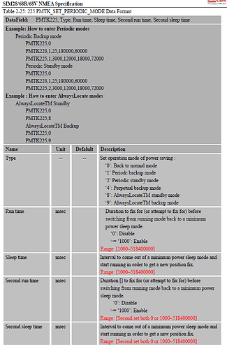

I am using a Grove GPS module in combination with the arduino MKR NB1500. I use the UART interface (RX/TX).
I am trying to put the GPS module into sleep mode, which is possible according to the datasheet.
However, i am unable to succesfully send the command to the GPS sensor. I tried gpsSerial.print and gpsSerial.write, both not working. My code is shown below:

    gpsSerial.write("PMTK225,2,3000,12000,18000,72000");
    gpsSerial.print("PMTK225,2,3000,12000,18000,72000");

Anyone knows the correct sentence to send a command to my GPS module?
Are you sure that the command sequence should be a string ?
Please post a link to the GPS manual
Good point! I am not sure if it should be a string. I also can't find an answer to that in the datasheet.
Here the link of the GPS datasheet
https://files.seeedstudio.com/wiki/Grove-GPS/res/SIM28_DATA_File.zip
I did manage to send a different command with succes which puts the GPS in low power mode.

    gpsSerial.println("$PMTK161,0*28<CR><LF>");
    test = 1;
  if (currentTime > 90000 && test1 == 0) {
    Serial.println("Put GPS on:");
    gpsSerial.println("$PMTK161,1*28<CR><LF>");
    test1 = 1;
Although this command works I still have no idea why the first command didn't work. If someone knows i am curious to know :smiley:
