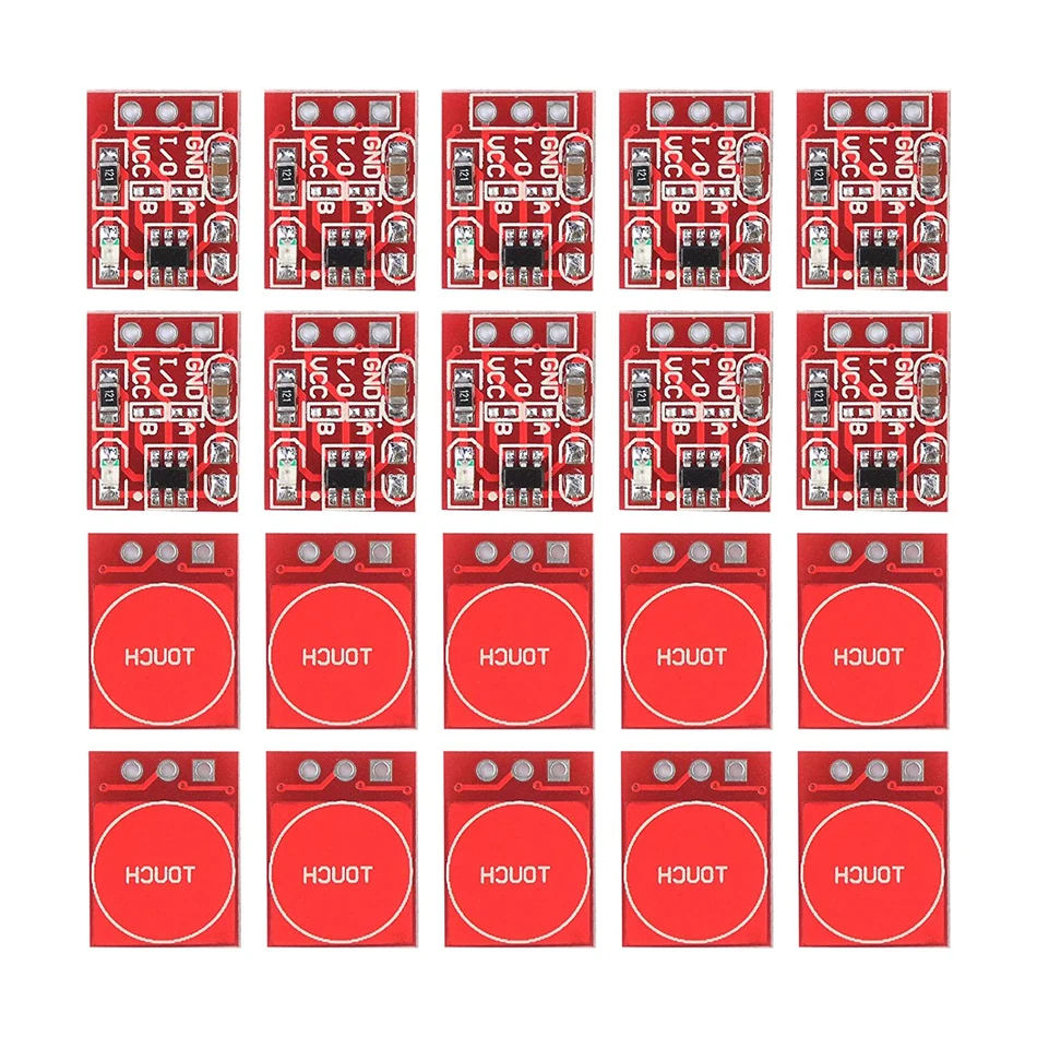

For thin wood (3 mm or so) you can glue a TTP223 based touch sensor behind it. Works like a charm. They're very cheap, too.

I ended up ordering the TTP223's, now I'm trying to find out if I can connect them all to a single Analog pin, so if one (or more) of the sensors is triggered, that would trigger an LED strip.

The datasheet cites "Open drain mode by bonding option, OPDO pin is open drain output". You will have to find out whether they have an open drain output (which I suspect it is), or a push-pull output.
Set one up on a breadboard. Connect the output pin first through a 1k resistor to the cathode of a LED with its anode to the supply voltage. See how the LED responds to touch.
Then connect the output pin through the 1k resistor to the anode of a LED with its cathode to ground. Again, see how the LED responds to touch. If the LED does not work with this connection, then it is "open-drain" and you can directly connect a number of them to the one input and it will signal when any one of them is touched - but you will of course not know which was touched.
Not sure why you would want more than one sensor however, since you would generally simply be connecting the touch terminal on the module to the foil on the back of the wood. Perhaps you should elaborate what you are actually doing now?
I remember they're push/pull, no need for external pull-up. So you can use them with an analog input and resistor ladder to see which one is activated.

By default they're active high. Place a diode in each sensor's output, cathode pointing to the Arduino, and add a pull-down resistor (10k will do). That's a basic OR port: if any one sensor goes high, the pin pulled high, while the other sensors are unaffected.

I got all the materials and got everything connected together, but it seems to work only if I don't connect the resistor to ground.
But it works! :smiley: Is there a problem if there is no resistor connected?
There is also another slight issue - when I have the signal wires connected via a diode for each sensor, I sometimes get residual signals coming into the arduino.
What I mean by that, is that the LED on the TTP223 is turning on/off correctly, but the arduino's LED and the serial monitor are sometimes still triggered for a few seconds after I put my finger of the sensor.
It's like the diode would continue to provide a little bit of current of its own, (like a small capacitor?) after the sensor stops sending out a signal.
Does this sound logical? Is there a way to remedy this?
Thank you guys again for all the help so far :slight_smile:
That pull-down resistor is supposed to solve exactly that: it's a clear sign of a floating pin.
Just checked the datasheet, at the bottom of p.2 it's confirmed the output is push/pull. So that's not the problem.
What resistor value are you using for the pull-down? It should not be too strong, or the TTP223 may be overloaded and unable to pull high the pin. Around 10k is a good value.
This prevents the pin from floating, which happens when all TTP223 outputs are low. Residual charge (due to a.o. stray capacitance of the wires, the input pin and the diodes) may keep the pin at high level for a while. The 10k resistor makes sure that charge is gone quickly.
