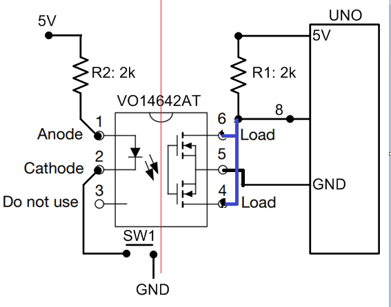

I would like also to have my arduino to be able to identify when the button is pressed manually. One of the ideas I came out with is to use an o the idea would be a spare SSR (VO14642AT), connected to the push button as follows:
My logic is:
  • Normal operations push button not pressed, SSR is on, the arduino pin is HIGH
  • Pushbutton is pressed, SSR is off, the arduino pin is LOW
Would this work or there a better logical way to do it? Also the fact that the digital pin would be the majority of time high, and the SSR on is that a potential issue long term?

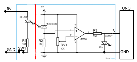

Try this circuit (Fig-1):
Figure-1:
When you press SW1, the logic level of DPin-8 will be LOW.
@GolamMostafa I really appreciate your reply.
Just to clarify, SW1 and the relative 5V and GND are part of a separate PCB independent from the one where I want to run the Arduino and the SSR. So the red line is the separation between the two circuits, is that still correct please?

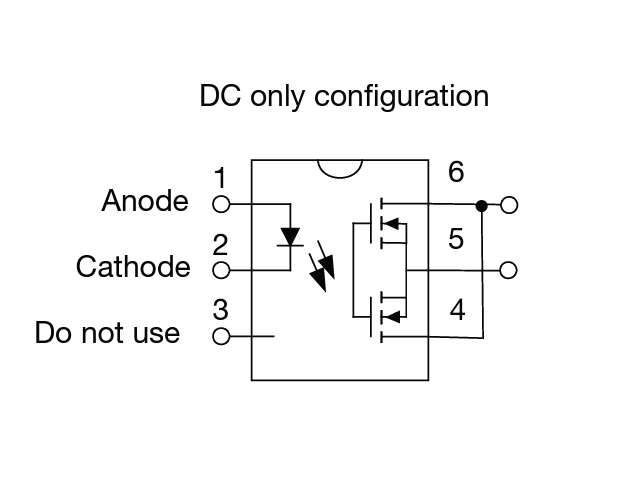

1. VO1464AT is an opto-coupler. The Light transmitter/receiver are integral part of the chip.
2. For remote control operation, you need to use IR transmiiter/receiver of the following type:
IRUno
If you look at the opto spec/data sheet.

@TomGeorge yes you are right, in the first schema this was correct, thanks for noticing it.
After the review and a test, I realized that the original pcb with the push button, needs to be modified, and i cannot just extend the two contacts of the push button to the second pcb with the arduino, this is not enough.
i would like to keep the two circuit isolated as they are different. I was thinking as alternative measuring voltage between the two pins of the push button, but want this usually is done with a voltage divider, not sure if i want to keep the two boards independent.
Any suggestion please?

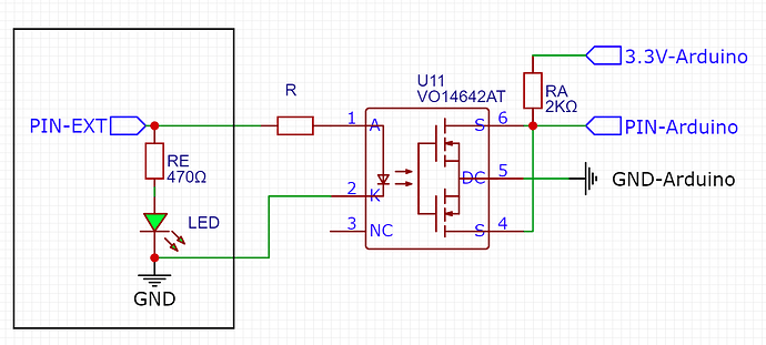

Coming back on this topic and after having given some thoughts.
The ventilation controller board has actually a LED which turn on when the system is on the speed 3 which I want to monitor.
My overall goal is to know when the ventilation is on speed 3 which is when the led of the board is on.
I was thinking of placing the SSR in parallel to the LED, as follow and monitor the pin input of the Arduino when low = led on = speed 3 is active.
What do you think of the below please? I still want to keep the two boards totally separated and I cannot modify the original ventilation board if not soldering some jumper cables.
I still need to measure the voltage from the pin to the GND of the ventilation board

The post got a bit confused overtime. I explain here again:
I want to remote control the ventilation system I have. This is controlled by a board which has 3 led and a push button. Each led indicates the speed of the ventilation, and with the push button at each press it is possible to cycle through the speeds (1 -> 2 -> 3 -> 1 -> ...) (there is no 0).
The board is part of the ventilation system and cannot be changed. I can though solder some cables to do some connections. I also would like to keep the ventilation board and my arduino board for the remote control separated.
I can already remote control the push button with a relay, now the next step is to understand the speed (1, 2, 3). The next idea I came up with would be to monitor if the led 3 is on. I'm excluding using a LDR.
So I was thinking of using the SSR in parallel with led 3 of the board, so that ideally when the led 3 is on, the SSR is active, and trigger a status change of a digital pin of the arduino.
