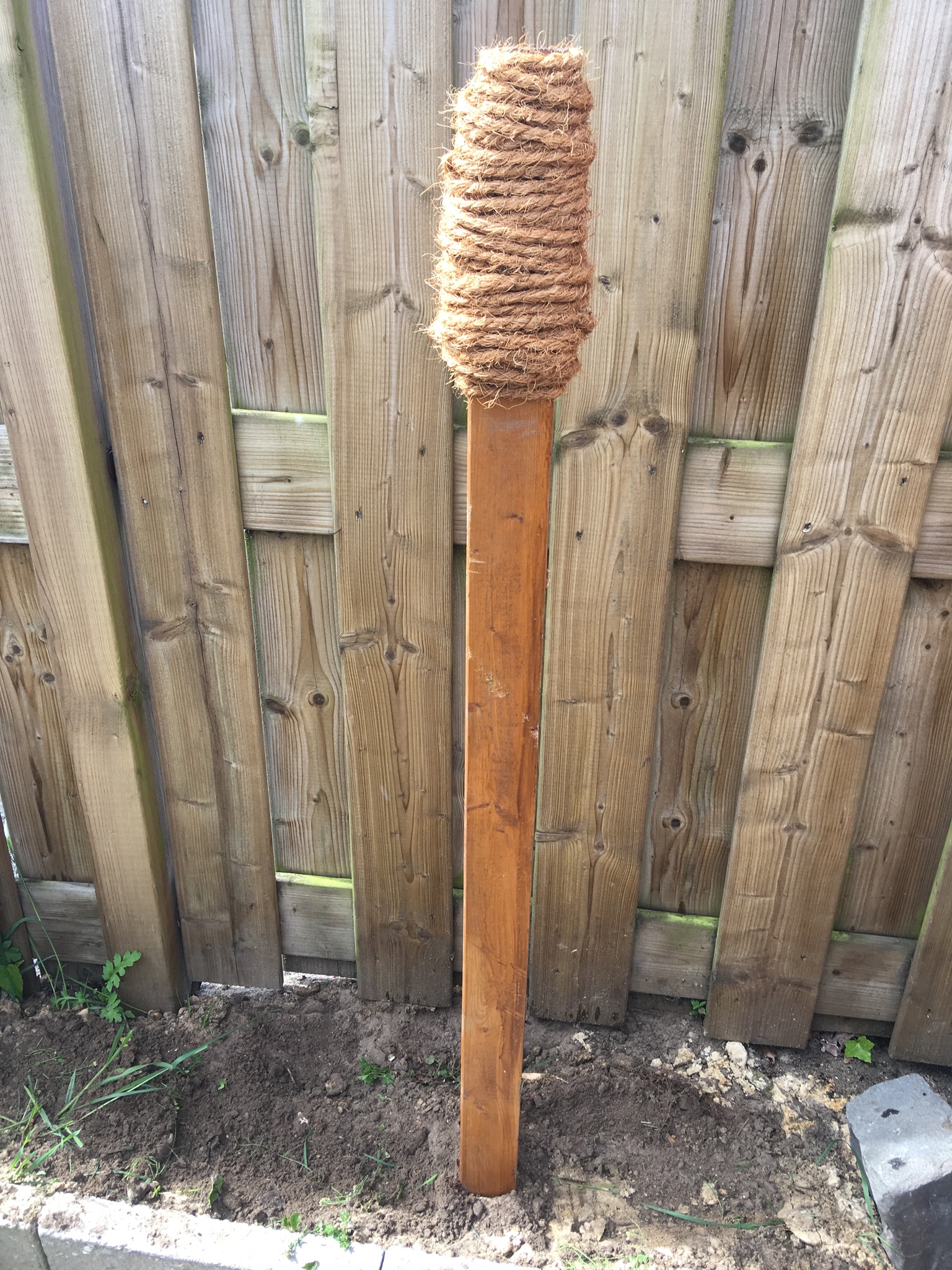

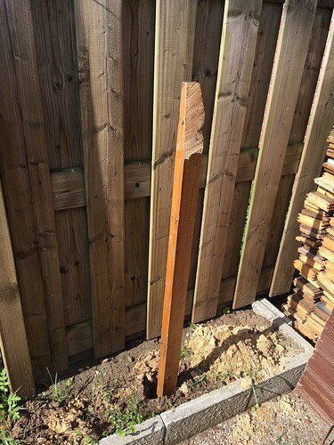

Or I could use a trainings punching bag. Put a fsr behind it. And if so? Which one? I broke my own made Japanse wooden makiwara…. The sensor must be able to measure. Like earlier mention close to “reality” as possible..

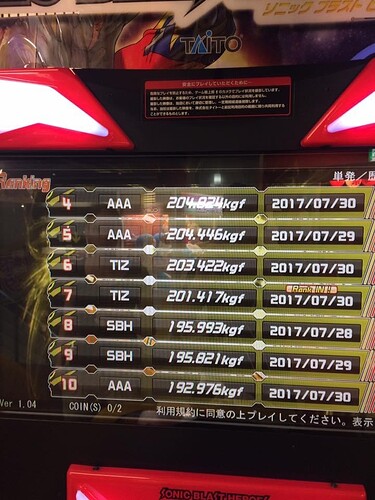

I want to know the best way. For a martial arts geek like me. In Japan I was hitting 203kgf, not even pushing to the max. Just for fun. Like punching arcades in all forms :pray:t2:. Curious how that got measured. Cos was a standing up bag. You had to punch downwards.

< speculation >
The "force" measurement system in an arcade game or other device probably varies by manufacturer. I doubt there are any industry standards for such measurements. And I bet there is little to no way to know how the Taito measured the 204 kgf shown in your image. Furthermore, if two games or devices happen to show that your punch has the same "force," it's probably a coincidence.
< /speculation >
Of course, there's always F=ma, but the devil is in the details.

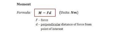

well what about using a makiwara board to measure force from an accelerometer, the method i use is using moment: M = F*d
How do you get from momentum to Energy?
After the punch you can measure the kinetic energy directly:
E_kin = ( m_ball * v_ball ^ 2 ) / 2
.. and then you can convert E_kin to whatever you like.
How are you measuring moment?

i use {isplaystyle {ec {M}}=I{d{ec {mega }} ver dt}}, in this situation which is a makiwara board, I will be {isplaystyle I={rac {ml^{2}}{3}}}|0x0, the dw/dt thing is the acceleration that is being measured from the accelerometer then divide it by the length of the board
