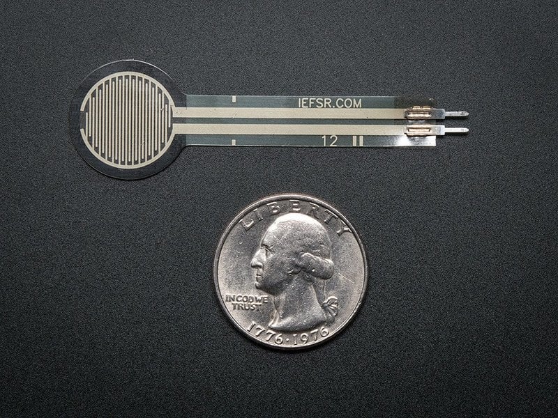

may be look at force-sensitive resistors (FSR)
I use piezoelectric sensor. But be careful, it generates high voltages, so protect the input pins on your board with a resistor or a zener from the pin's maximum voltage.
