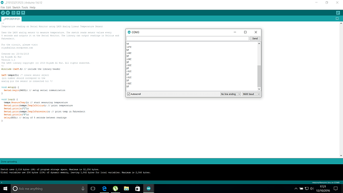

hi, I have problem with my sensor ds18b20 in different ways... I copy the code from internet and I have different outputs from them.. so i decided to use this code:
i did everything from there and still don`t work.. any help?
and here is the output from another code.. why is the output that strange?
What is strange?
Post your code, not a picture of it, and post a schematic, not Fritzing and not a photo of your hardware. Draw it in pencil, if you have to, and take a photo of it or scan it.

Your photo for reply #1 shows code for an LM35
AWOL:
yea because that`s the only code that show something else other than 0, and i understand that this sensor have inside an lm35 so i tried it..
Make your mind up. Is it an LM35 or a DS18B20?
Pete
what u see in that photo thats what I know too... I buyed it as an BS18B20, thats for sure. But I sayed that about lm35 just because a friend told me that inside its lm35 and shuld work that library too... just sayin
