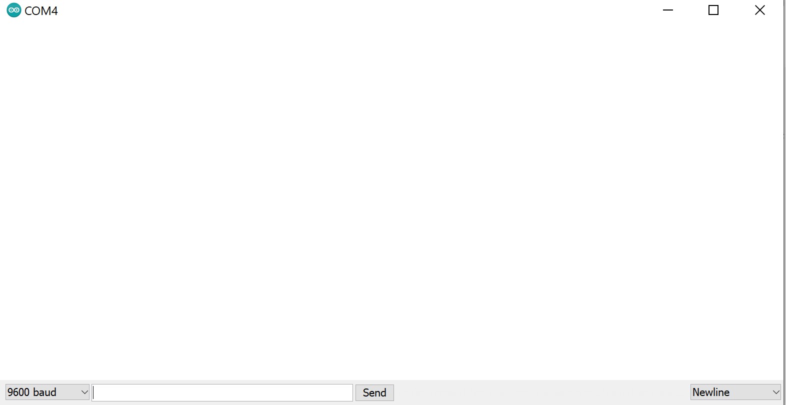

Serial monitor and plotter coming up blank
I'm looking to calibrate a load cell and for some reason, when I open both the serial monitor and plotter, they both come up blank. My plotter is set to the corresponding 9600 baud, however, this doesn't seem to change anything.

here are screenshots of the potter and monitor:

Ok, well, the serial plotter is unlikely to show anything with that code, but you should be able to see something on serial monitor.
Have you selected the correct port? For example COM1 or /dev/ttyUSB0 or something?
What kind of Arduino are you using?
My thoughts exactly, it should at least show something.
Yes the correct port is selected )which is COM4 only instance)
I am using an Arduino Nano
Hmm... What if you click the Nano's reset button while serial monitor is already up? Do you see the "HX711 scale demo" message?
Do you have anything connected to pins 0 or 1?
Hitting reset doesn't seem to do much. Also I have nothing connected pins 0 & 1
Well, using Serial Monitor is one of the most basic functions of Arduino, so something pretty basic must be wrong if it isn't working...
Can you upload the basic example Blink sketch and confirm the built-in led flashes?
Can you upload the basic example DigitalReadSerial sketch, attach a button and see the output in serial monitor?
