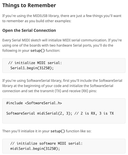

Suspect the MIDI library uses the defaults serial port (pins 0 & 1).
Try using Software Serial for the MIDI communication.
Think you very much!
