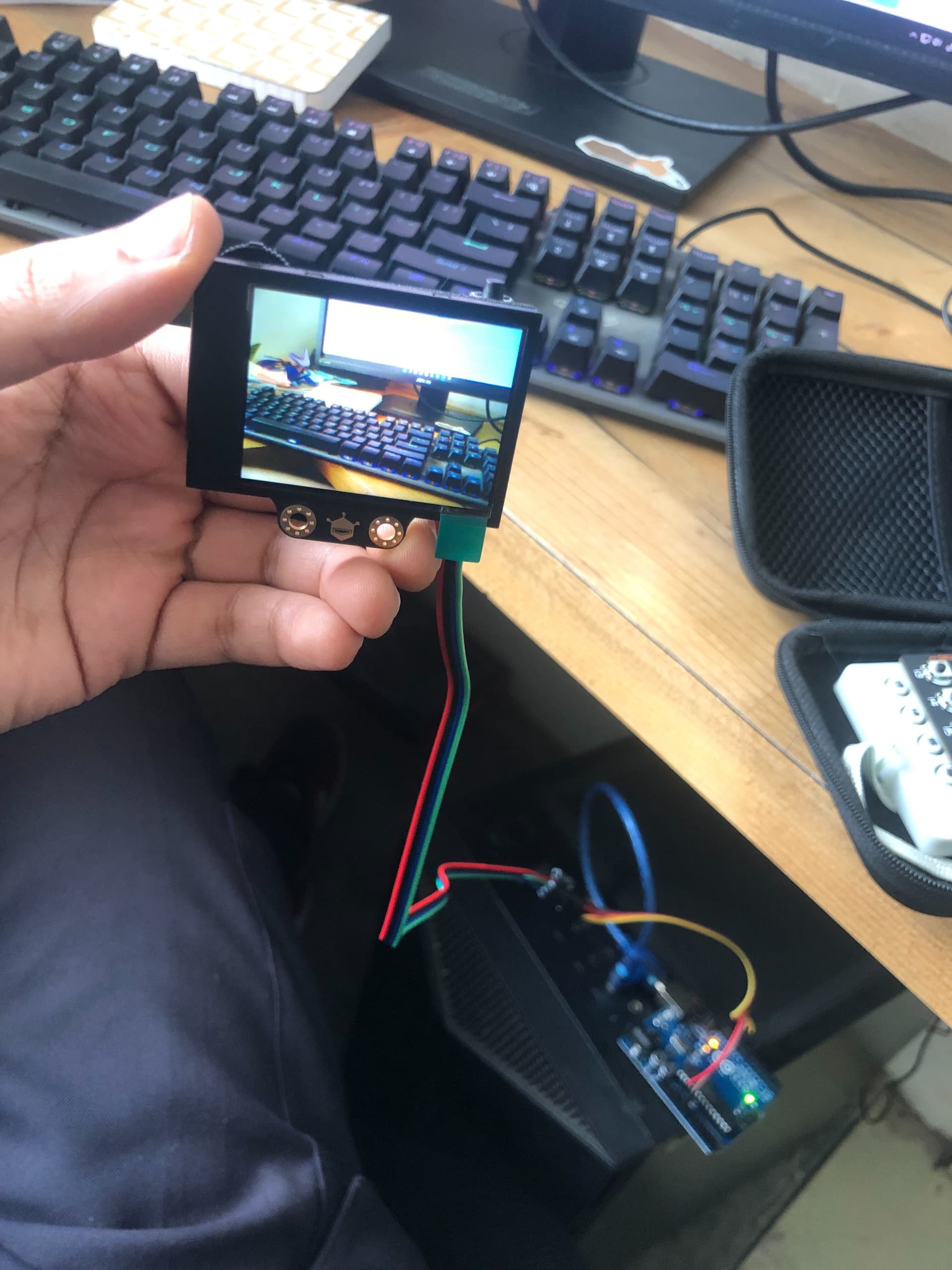

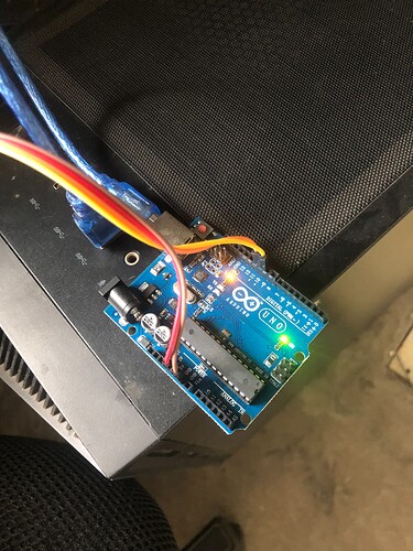

Hey all!! I am trying to connect my 'HuskyLens' to arduino UNO board but I am getting bad characters on serial port dipsplay. The baud is also set to 9600 as told in this document

You will need to set the baud rate to match what is in your code

Hi, @appachandra
Welcome to the forum.
Have you got the IDE monitor set to 115200 baud?
Tom.. :grinning: :+1: :coffee: :australia:
