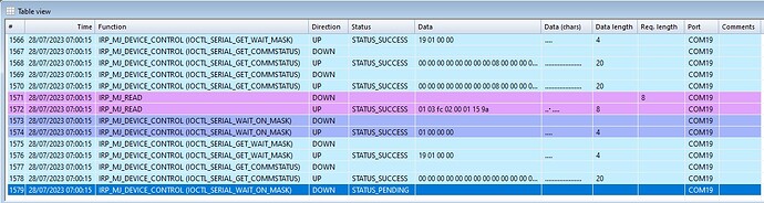

My EV charger comes with the RS485 lines, for connecting to a MODBUS energy meter. Using YAT (Yet Another Terminal) and a USB-TTL-485 interface, I could capture the initial MODBUS request as following:
01h 03h FCh 02h 00h 01h 15h 9Ah
repeating 10 times (timeout)
yat_mon
Simply, the EV charger asks for the model number of the energy meter.

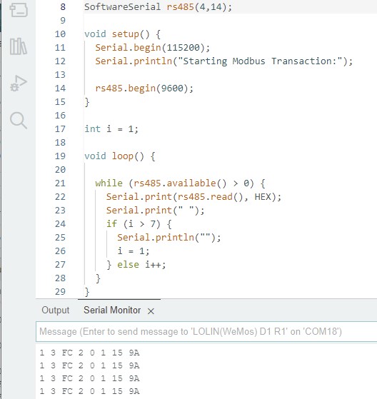

Then, I was trying to write a serial monitor using my WeMos D1 board, but the values received from the software serial were different. I'm not sure where to fix this.
My (pseudo)code is very simple:
   rs485.begin(9600);
   while ( rs485.available() > 0 )  {
     serial.print(rs485.read(), HEX);
     serial.print(" ");
The values (a MODBUS message) always started with 7F FD .... or 127 253 in DEC.
Any advice would be greatly appreciated.

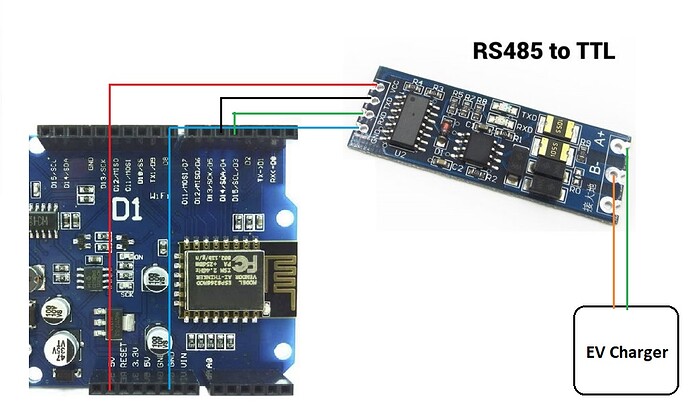

Sounds like the RS485 hardware isn't connected correctly. As you didn't post a wiring diagram and links to the hardware used we cannot check that.
Thank you for asking. In the code the Rx & Tx pins are assigned properly. There was data coming from the EV charger and the Rx led on the RS485-TTL converter was lit.
For YAT (PC serial port) capture, I just connected a USB-TTL (CH304G) converter to the RS485-TTL board, instead. It worked like a charm.

This is the actual code.
Arduino 2.1.1 IDE
library esp8266 by ESP8266 community
#include <SoftwareSerial.h>
/* RX = GPIO 5 (D3)
 * TX = GPIO 4 (D4)
SoftwareSerial  rs485(5,4);
   rs485.begin(9600);
     serial.print(" ");
I would check to see where the pins defined as pin 4 & pin 5 appear on your edge connector. It may be that the board you have selected places them on different io pins.
Do you mean the actual pins of the Wemos D1 where I made the connection. Or the diagram of pins mapping. Please forgive me if I might not understand your request fully.
[Wemos D1 pins - #15 by Juraj] Wemos D1 pins mapping
BTW, I have done some projects using software serial on these D3 & D4 pins (as well as others), connecting with PZEM energy meters 3 phase on a single Wemos D1, MODBUS RTU Client, etc, successfully.
This is the first time, I use the low level funcations such as serial.read();
If you have selected Wemos D1 R1 in your boards manager, then the pin numbers used in the sketch should in theory be as shown in that image that @Juraj provided in the post.
I have one of those boards myself but i've not used it yet.
I've also seen a pinout that suggests that what is labelled D2 on your image in post #3 is digital pin 0, with D3 = pin 1, D4 = pin 2 etc.
If you have an LED and a resistor, you could run the blink sketch and map out which pins map to where on the headers.
The Wemos D1 uses CMOS levels (3.3V) and not the TTL levels (5V) of your RS485 adapter board. You might have fried the inputs of your D1 already.

Have you got a common ground between your WEMOS, the RS485 module and the charger?
Here is the MOBUS library.
The RS485-to-TTL board can take Vcc 3-30V so I put 3.3V instead of 5V. The USB-TTL also has a 3.3/5 Vcc switch.
The EV charger has no ground line, only A+ and B- lines. 2-Line works correctly with the YAT serial mon on PC.
The WEMOS feeds Vcc and Gnd to MAX485 chip on the RS485-TTL board. This is the same for USB-TTL to RS485 converter interfacing.

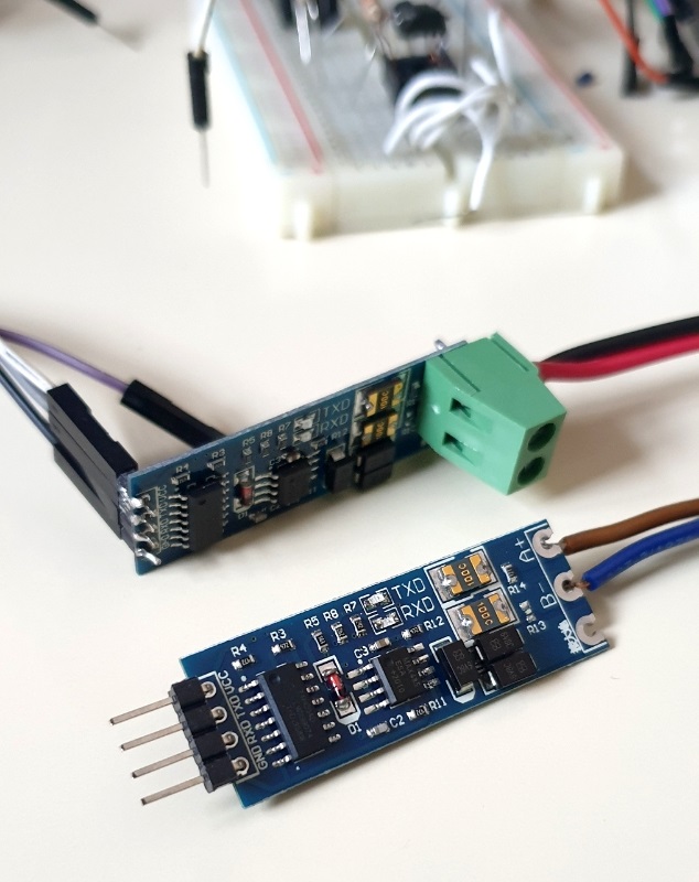

Post a link to that board! It's surely not the one you showed in the picture.
That contradicts with what you wrote above. A MAX485 cannot run on 3.3V, it's a 5V device only.
Thank you very much, pylon.
This is a photo of the actual board I use. I bought it a few years ago but had no project to play with, until I got an EV charger with RS485.
Here is a link: [UART TTL to RS485 Two-way Converter | Elecrow]
You are right about the 5V Vcc. The information on the page is incorrect. At first, I used 5V for all the testing I have done. Then I came across the page above. I just tried 3.3V and the Rx led lit up when the EV charger sent a request. This made me believe it worked. But the Serial Monitor app did not show any new coming messages.
So, I switched back to 5V and re-tested it. This time a message was detected.
I cannot find any hint that this board takes 3-30V as power source.
There are no schematics linked so it's pure guessing what components the board carries. It's cheap Chinese stuff, so it may work or it may not. And don't trust the vendor information as they link to the MAX485 datasheet and that series of chips isn't compatible with 3.3V signals. Maybe that larger chip on the board is a level converter but I don't see a voltage regulator, so too much guessing. If it doesn't work out of the box as expected, assume it contains fake chips.
That's on the PC, so what does that show?
Why's that a success? I thought the messages always showed up on the PC (see post #1).

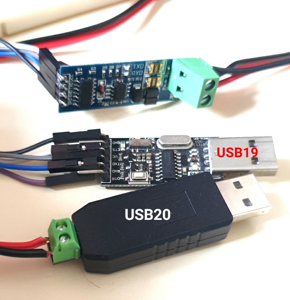

I ordered a USB-RS485 dongle and just received it today. So, I did some testing and it was very strange, beyond my knowledge. :sweat_smile:
In my first post, I captured the message through the RS485-TTL board + the TTL-USB board ("USB19"), using my notebook. Later, I did all the tests on my PC with my EV charger laying nearby.
Here is my test setup:
I chain 2 USB-RS485 devices. USB19 is using RS485-TTL-USB boards while USB20 is the RS584-USB dongle.
Before this time, I had done all the testing using USB19 hardware. The YAT capture always showed:
I tested the RS485-USB dongle and it showed the same result. Then I plugged both 2 USB altogether, showing USB19 and USB20 in the YAT program.
But the led on the RS485-TTL board stayed lit up and the board seemed to be frozen. So, I unplugged the two units out and tested only one of them at a time. The results become strange, as in the picture.
yat-usb19-20
The upper part is from the RS485-USB dongle (USB20). The lower part is from the RS485-TTL-USB (USB19). I repeated the test 3-4 times and the results were the same. I don't know what happened to the hardware, or software-wise.
And this was the situation/problem I found when I used my Wemos D1 read messages from the RS485-TTL-USB. The numbers are different.

I think I know where the problem is. It looks like the power supply problem using old jump wires (Dupont). Some of them have rust on pins, and my Wemos D1 is also aged 4 years, rarely used. Its connectors might be not clean.
Finally, the serial.read() displays the same message values with those of YAT :rofl:
