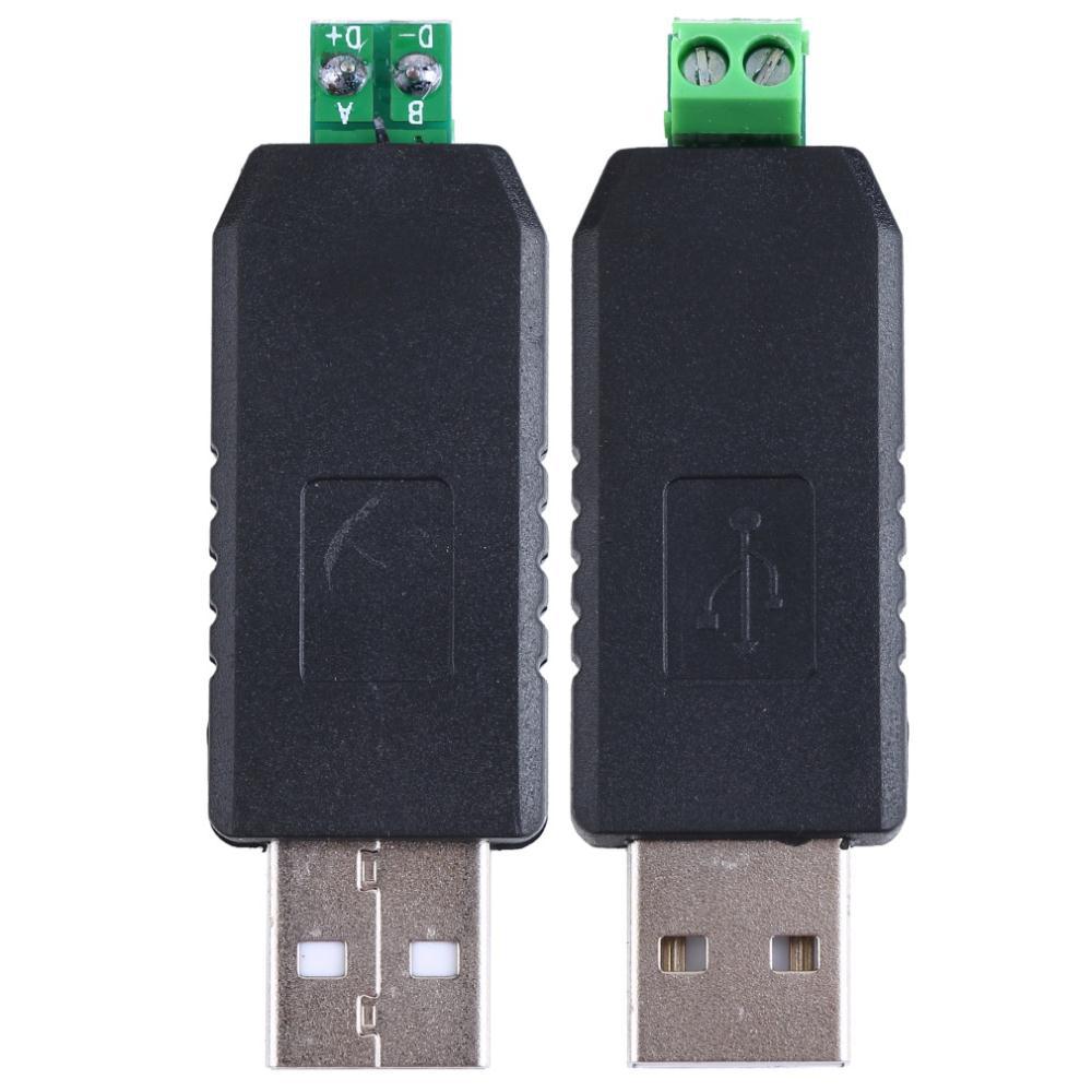

Please provide a link to the exact product of USB RS485 converter you're using. The schematic of the cable and how the DE pin is signaled might be essential. It might be necessary to bring the RS485 bus to a defined state if no driver is enabled. I use one set of resistors on the bus to pull the two data wires up/down.
Edit: The ModBus message CRC is OK if the leading and trailing zero bytes are removed.
I see why the "SimpleModbusSlaveArduino.ino" doesn't work. The serial interface is configured to 8N2 while the PC uses 8N1. From which sketch do the two screenshots originate?

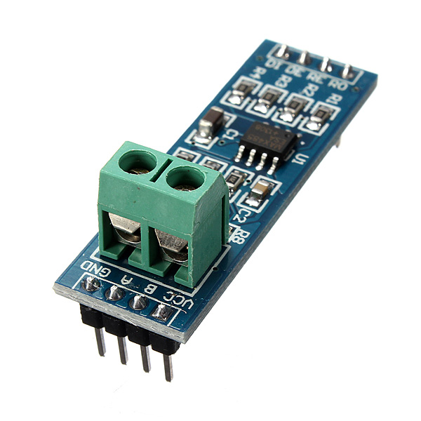

This is a module for TTL<=>RS-485 : MAX485 module - TTL to RS-485 module
This is a module for RS-485<=>USB :USB to RS485 Module (CH340)
The USB-Module seems to be a pretty normal USB2Serial with a RS-485 driver. The TTL-to-RS485 module doesn't provide a schematic (at least I couldn't find one) so I tried to find out how it's wired from the photos.

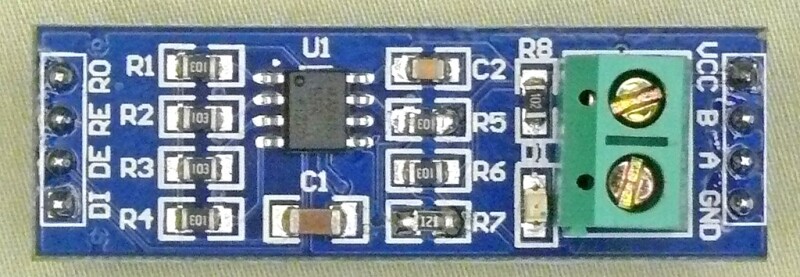

R1 to R4 seems to be directly connected to DI, RO, RE and DE, so they're just for chip safety. C1 or C2 is the decoupling capacitor for the MAX485. R8 is probably the current limiting resistor for the LED. I don't know where the LED is connected to and what the second capacitor is used for. I also cannot find out what connects to resistors R5 to R7. Can you try to find that out?
TTL-to-RS485 module schematic : Link To the Site for Details
and a Top view of Module :
At least on the picture in your last post the resistors R5 and R6 are 10kΩ and not 20kΩ but that make little difference. Using this module the bus gets set to 2.5V without any driver active with a difference of A and B of only about 30mV which is below the sensitivity of an RS-485 receiver. To get a good result you should use a pull up/down resistors (what R5/R6 are doing) of 600Ω - 1kΩ, at least in my experience. If you ask the RS-485 line termination calculator it says the resistors should be about 540Ω. Because the USB adapter has such resistors (a bit too big, 2.2kΩ) it might work without is but I would install another 2.2kΩ to get better results. If you have the possibility, measure the line with a scope.
Also remove the terminating resistor you have in your schematic(SCH.png) on the Arduino side because that is already on the board. If an Arduino board is not at an end of the bus you should desolder the resistor R7 from the board because that's the termination which should exist only at the ends of the bus.
