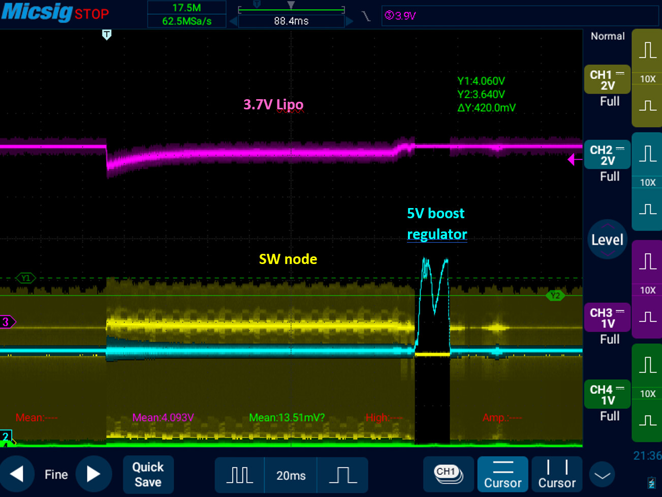

Servo causing positive voltage spike
I have a 3.7V lipo powering an ESP32.
I also have a boost converter that outputs 5V (https://www.amazon.com/dp/B091CRCZ65
When I command a new position:
  1. PWM changes
  2. battery current draw, so sags
  3. Position is reach, so battery recovers
  4. 5V supply overshoots???
What is going on?? The boost converter stops switching, as it realizes the 5V output is too high.
But, the output keeps rising.... I added an addition 100uF 10V X5R 1206 capacitor across the output and input of the boost converter, but it still does the same thing.
Edit, I also measured with a 0.1Ohm shunt on the servo ground line, that the current does go a tiny bit negative during the time when 5V overshoots.

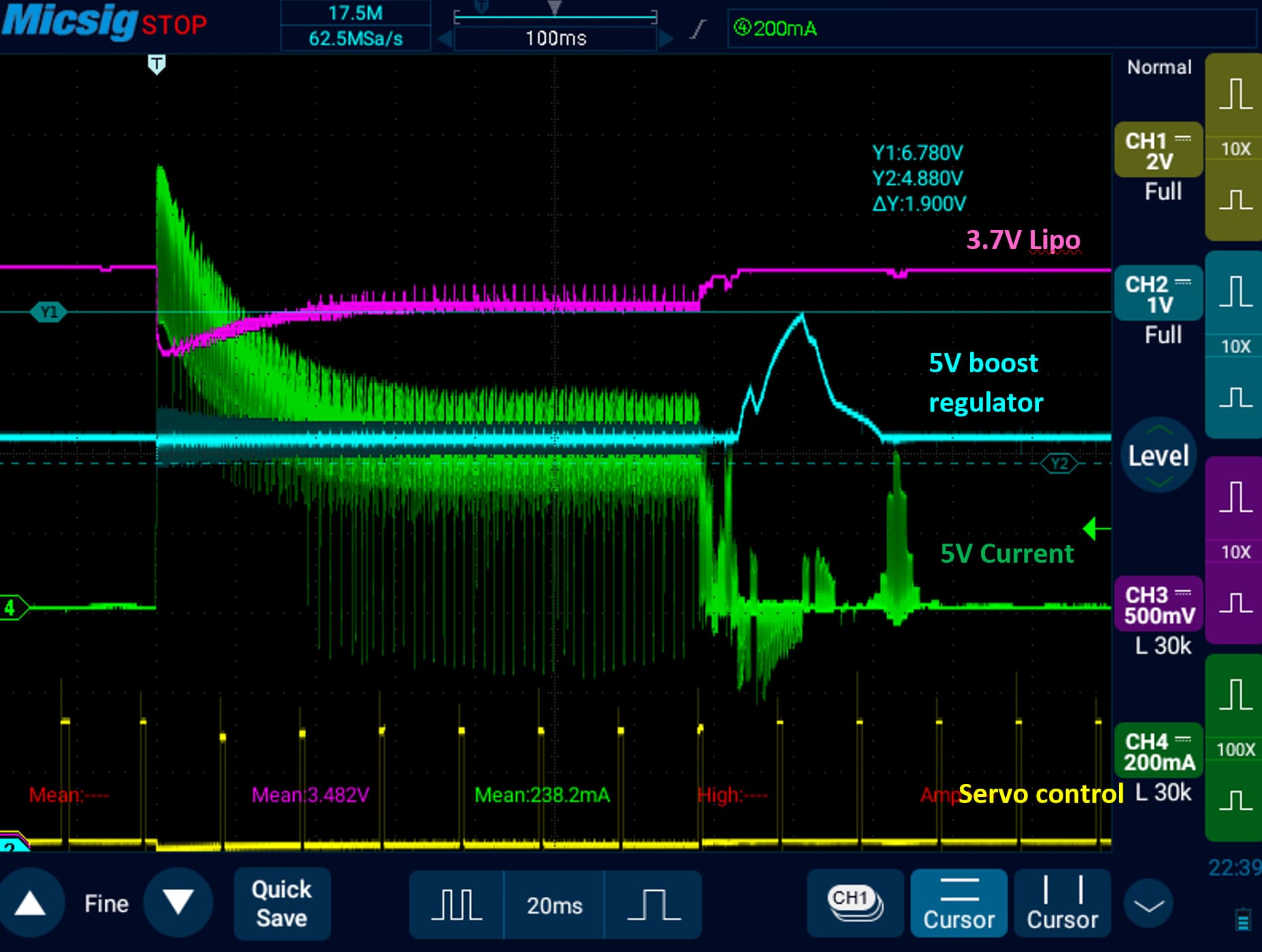

Nothing strange, in general. If You post a link to the servo datasheet we will know more. 1 Amp output might be too little for that servo.
It's a MG90S I bought on Amazon.
Negative current is normal? Here is a scope shot showing the negative current corresponding to when the 5V rail overshoots.
Edit:
Is it safe to have the 6V rail hit 7V?

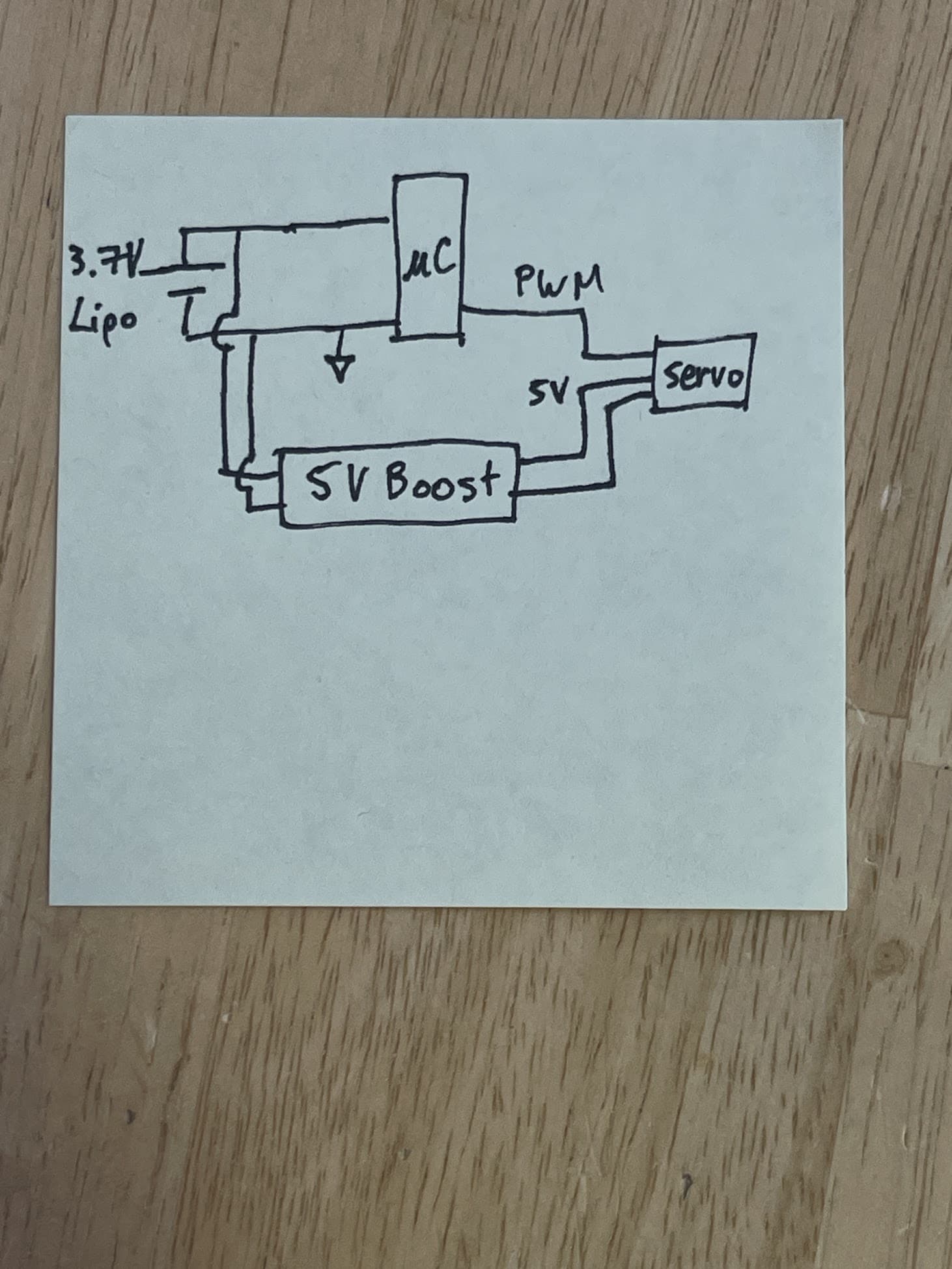

Hi, @h2e
Can you post some images of your project?
Please include where you have connected your scope probes.
Can you post a link to data/specs of your DC-DC converter?
I think for any useful response you will need to provide a schematic.
How to make a schematic you can post. - Using Arduino / Introductory Tutorials - Arduino Forum
However the physical layout is also relevant so a photo of your setup please
Take your current measuring resistor out of the circuit, I think is is causing about 1/2 of your overshoot.

I initially did not have the current sensing element; adding/removing it made no appreciable difference.
The circuit is extremely simple.
Given it is a servo, and it moves in both direction, it must have an H-bridge circuit and intrinsic diodes...
But I think it makes sense now to me.
When it is moving fast to one position, current will flow through two switches Q1 and Q4 in red.
When it reaches the position, the servo could do two things...
  1. Turn off only one of Q1 and Q4. This will let it "freewheel". For example current through Q1 and D3, or Q2 and D4.
  2. Turn off all switches. Then, current will flow through D2 and D3, and charge the 5V rail.
It seems the servo I have does (2). Not sure why though.
The boost converter and the battery combination is inadequate to handle the start/stall current of the servo, and the circuit lacks proper power supply decoupling.
Due to boost converter inefficiency, 5W output to the servo requires about 6W input from the battery, or 6W/3.7V = 1.6 Ampere battery current draw.
No surprises at all.
