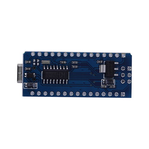

You used the nano to provide the 5V for the servo, thats a NO NO for any arduino.
Even the smaller servos need more peak current than the controller board can supply to move.
MG996R servos are big power hungry servos. As Tom suggested, it's not a good idea to power any servos from an Arduino's 5V regulator but sometimes you can get away with it if you use a small servo and you don't drive the servo past its physical limits.

Cap or no cap, if you're still powering the servo from the Arduino, you'll fry another Arduino. It MUST have a separate power supply. That's a high-torque (high-current) servo. The Arduino regulator isn't.
