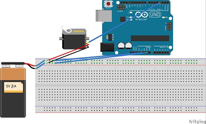

I have a problem with my servo (TowerPro Mg995) as it starts acting randomly(more like crazy all over the place) when connected to Arduino board and power supply. below are the system specs:
Board: Uno
Servo: TowerPro MG995
External power supply: regulated 5V @1A max output
Ground connections are shorted of course.
Code

I wonder why you have used a picture of a PP3 9v battery when you really mean a 5v 1 amp power supply?
If you are connecting the 5v supply to the Arduino 5v pin are you quite sure that it is a regulated 5v supply that won't harm the Arduino?
What happens if you connect the Arduino to your PC with the USB cable instead of the 5v supply?
It may be that a 1 amp supply does not provide enough current for your servo and the Arduino.
...R
Robin2:
Because I don't want to get into source details which is supplied by a battery in the first place.
Robin2:
The source is regulated, used a voltmeter on several instances and it holds at 5V.
Robin2:
Connecting the Arduino to PC and the motor to external power supply yields the same thing.
Robin2:
I'm really not sure, it happens with two identical servos so its not a bad motor.
ibro191:
That suprises me. When you are connected to the PC do you have the servo GND connected to the Arduino GND (you should).
I am assuming, since you have not told me otherwise, that this problem happens all the time the Arduino is running and not just for a few seconds at start-up?
Try a shorter delay() - say 1000 for 1 second - and put some Serial.print commands in your code so you can see if the Arduino is behaving properly. Try this

Robin2:
Grounds are connected.
Robin2:
As long as the Arduino is executing the code the servo keeps on swinging back and forth relentlessly.
Robin2:
I have tried that, same thing. Servo out of control but the board doesn't reset, counter goes on uninterrupted.
Servo Does not stop for one second until I plug it off or disconnect from Arduino PWM pin. Then it holds still.
Could it be a current problem? a 1A current somehow insufficient ?

ibro191:
Then I reckon your servo is faulty.
Just to clarify, the 1 second (or your 100 second) delay will have no impact on a good servo. You only have one instruction telling the servo to go to 150deg and when it gets there it should stay there forever.
If you want to see the effect of the delay() you need to tell the servo to move to a different position and wait there for an interval before moving back to the first position.

ibro191:
I am aware of that, what I was implying is the continuous motion of the servo even though it has to stop at some position per command.
You are still misinterpreting how the Servo library works. The servo library continually sends a signal to the servo regardless of whether or not you have delay()s in your code. The only way to stop is to use Servo.detach().
