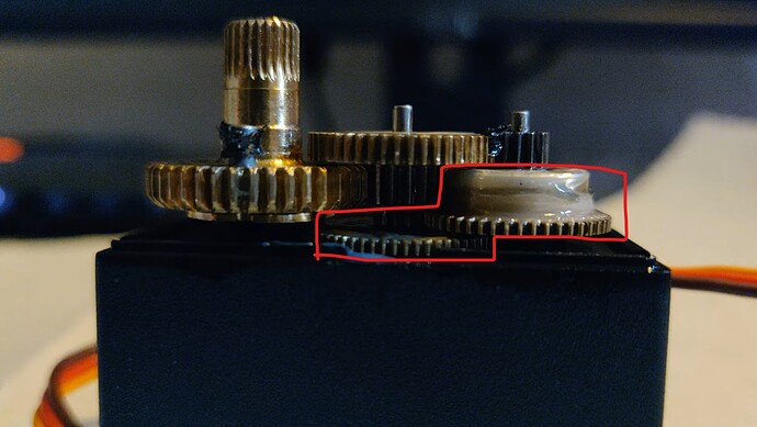

Whenever I try to control the servo, the shaft doesn't move. I took the servo (MG996R) apart and it looks like only some of the gears are rotating.
The gears circled in red in the picture are the ones that are rotating while the other ones aren't. Is there any way to fix this issue?

Gears might have lost teeth, tooth wheel slipping on the axle.

take them apart, degrease, reassemble --> you might find the cause. Probably an axis is out of place or a hole too big.
Inside the gearbox is a DC motor. Make sure the setscrew holding the main gear to the spindle. I would guess the motor drives a very small gear that meshes with the "bottom" gear circled in red.
