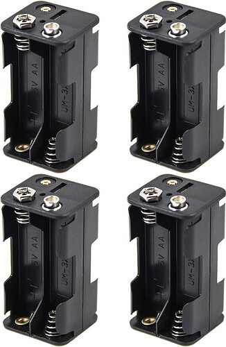

Use a 4xAA battery pack to power the servos, and connect the grounds.

So the 4xAA battery you mentioned, would it be sufficient to power multiple SG90 servos by your opinion? As, all in all I have up to 5 to 10 servos I'm working with

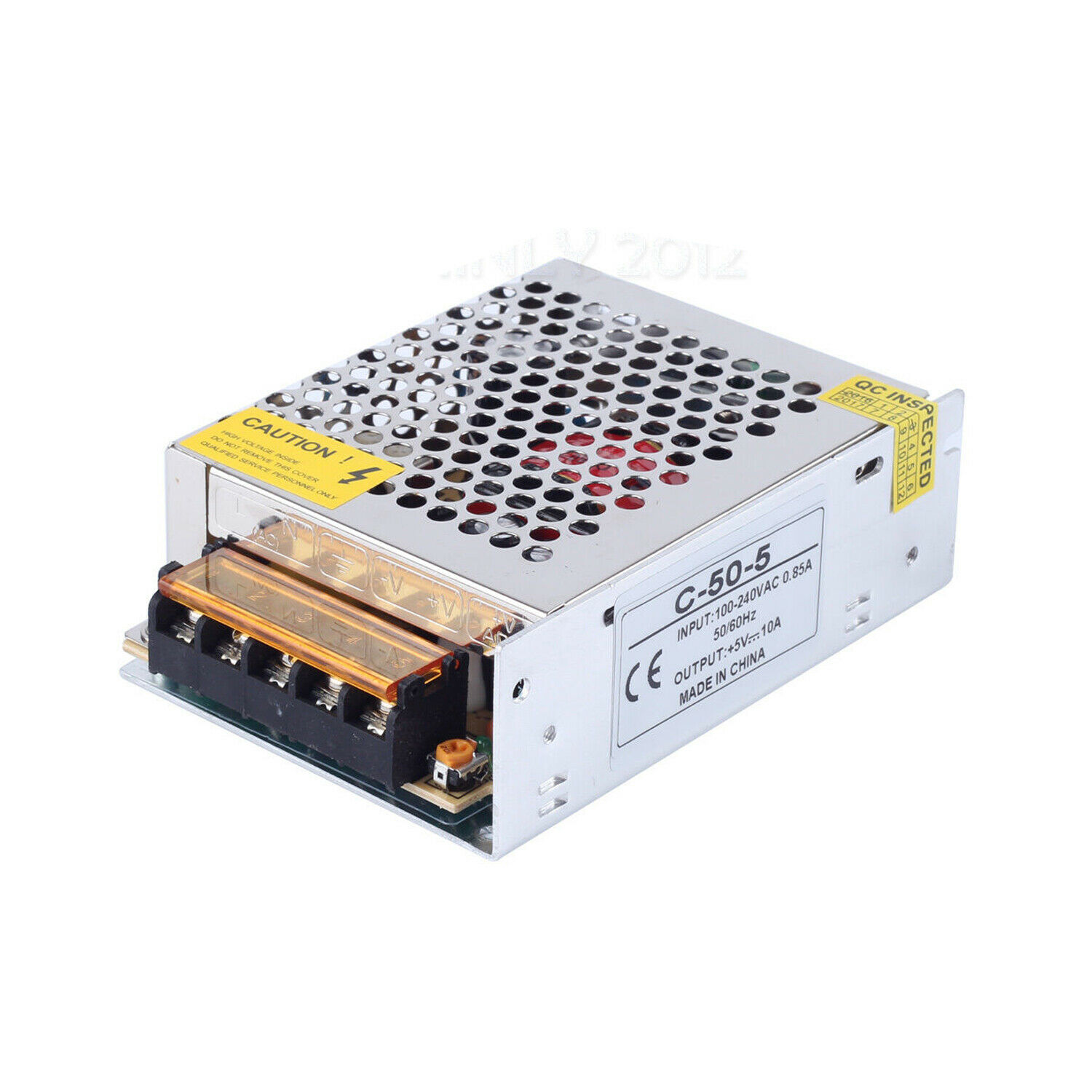

A 5v 10A power supply will only cost about 7 or 8 dollars on eBay.
Honestly speaking, there are only a few days left until this project submission and I don't think I can wait for a delivery to arrive. Would regular 4xAA batteries be enough as Jremington mentioned?
A fresh 4xAA battery pack of alkaline cells can provide about 2 Amperes, so it would be sufficient for only 2 SG90 servos.
Since you got such a late start on your project, consider an overnight delivery of a suitable battery pack from an RC model supplier.
I have used 4 AA batteries powering two MG996 servos in some projects, they work just fine.
However, three might be the maximum for 4 batteries; any more, you just get another 4. You will need common GNDs between battery packs and the Arduino.

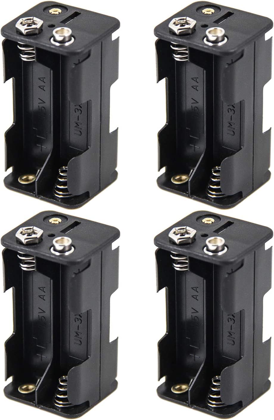

You can get 4 ā€œCā€ battery holders too.
Well, there are other battery options - 4 C or D size would be a better choice, unless you're keen to take a chance. It's not just the end-of-travel stall current, it's the fact that any mechanical binding, or even internal misalignments in the servo itself, can result in quite high currents. The spec sheet will identify a stall current max for your servo; a good worst-case plan would sum the stall currents of all your servos, add a margin, and provide that supply, but you haven't the time. Might be worth a footnote in your documentation, if this is for a school project, because identifying a deficiency is better than letting your instructor ding you for an oversight.
