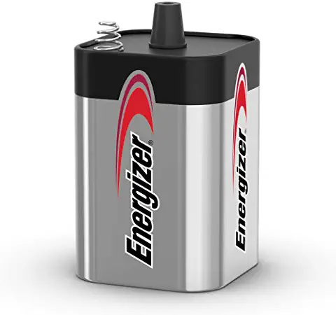

one option:
a second one:
But a 5VDC 2Amp wall wart won't cost as much as either of those:
