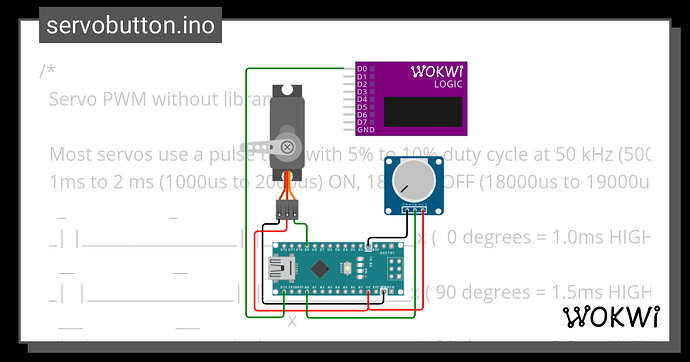

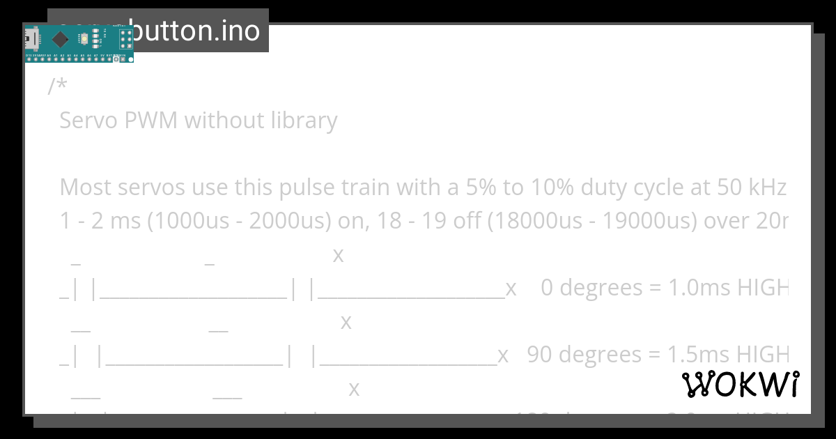

Following the good advice of @J-M-L to not use delay() (note the servo library you used probably used delay()) and @Etienne_74 to use internal timing to drive your servo without blocking mpu access to your sensor, I cobbled a simulation with some explanation in the comments.
You can see two events in the simcode... you need to discover where to insert your sensor-reading code, but it should not be difficult.
Have fun.

I made slight modifications to @xfpd code : I toggled pin D13 up and down for each Loop and added a Logic Analyzer to visualize the signal (or timings) with PulseView.
EDIT : I also added the servo pulse for comparison and centered the pot for "ease of use"
=> the up/down toggle takes 2 x 125ns (a digitalWrite() would have taken 2 x 1.75µs) and a complete loop takes 153.375µs (+ 2 x 125ns). That is the max jitter for the servo signal.
To be tested with interrupt and, even better, with hardware PWM...
