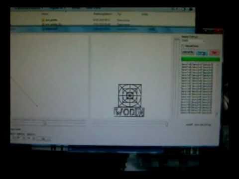

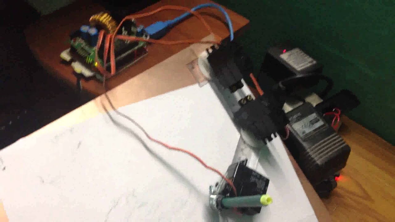

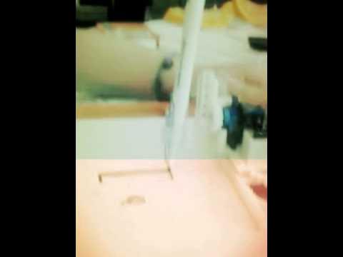

TRS drawbot
For an example of using a servo for drawing.
