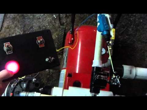

Actuate the valve. Just as you wanted to do it in the first place but use a car lock actuator
They are really powerful. Simply apply current and it extents. Change polarity (or use other wire) and it retracts
I'll post a video of it later (if I manage to find it)
