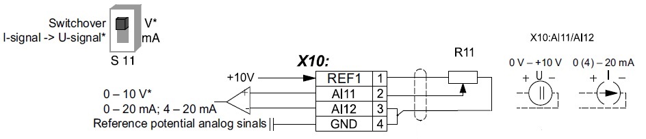

The image of the X10 "plug" comes from page 229 of the MOVITRAC B System Manual

My other question revolves around using the control of the Current if S11 is flicked to the bottom position. I have tried to do searches that covers this as an option with no luck.
The ultimate purpose of this plug/pot is to control the speed the drive makes the motor run at. Clockwise and Counter Clockwise directions are controlled by a separate 24V switching circuit.

Yes, using the device's own 10V output as the reference voltage for a potentiometer input is the correct way to do it. That's what the image you attached shows.
Look up "current loop". It's a popular method of controlling industrial equipment as it's immune to voltage spikes and most other kinds of interference you get in an industrial plant. Reading current loop signals (like from a sensor) is a simple matter of one resistor and an Arduino's analog input. Producing current loop signals is a little more involved. There's probably lots of specialised chips to do this.
Current loops are often specified as 4-20mA, which will map to the actual range of values being measured. This means that if the current goes below 4mA to zero, the reading is invalid, so you know that the wire is disconnected.

What you are talking about is a standard analog speed control input with picture x10.jpg
A digital pot, is an internal counter, that imitates a pot, that you use two digital inputs to increase and decrease the value of.
This counter value is then used as your setpoint speed for the movitrac to respond to.
See page 107 Motor Potentiometer.

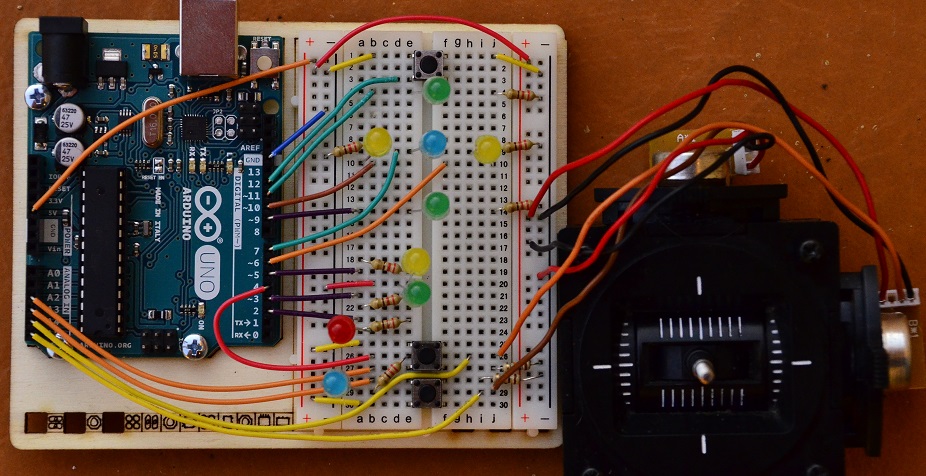

I will try post a some pics from my phone of my bread board which i am bust testing with.
See image below?

I hope a photo of the breadboard layout will suffice

That is an EXTREMELY NICE breadboard layout. The only advice I have for that is it appears the connection between the two ground rails on the board depends on the switch at the top. If you remove that switch for any reason then the thing stops working. I always put two wires on my breadboards and push them down beside the board, since they are virtually a permanent part of the breadboard.
