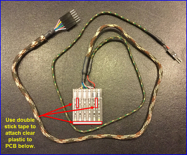

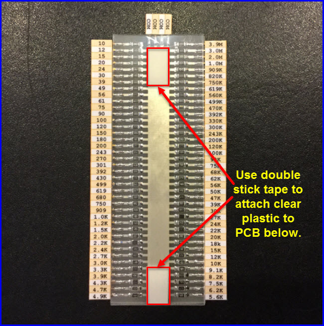

Every now and then you might want to protect PCB components with a piece of clear plastic.
The clear plastic allows LEDs, LCDs, etc. to show through and it protects things from accidentally shorting.

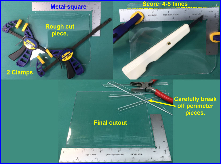

Save those old DVD/CD cases and use them to do the job.
These cases are about .05 inches thick and are easily cut to size.
