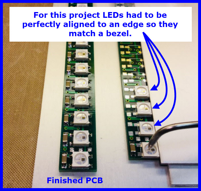

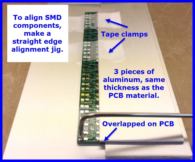

NeoPixel LEDs required a jig to position the edges.
The iron is set to 400'C which makes soldering time ~1/2 second.
