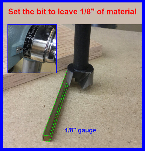

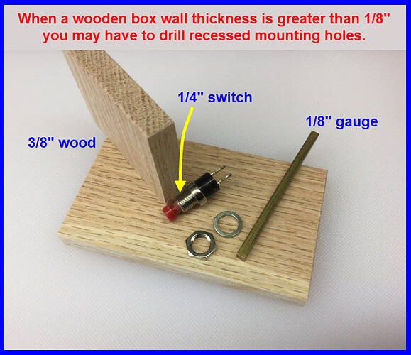

Mounting switches and other electronic components in a wooden box can sometimes be difficult.
The length of the switch, and the wall thickness of the box may be such that you cannot add mounting hardware to secure your component.
This discussion shows one method to make mounting such components easy.

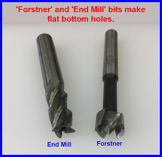

  • Forstner bit

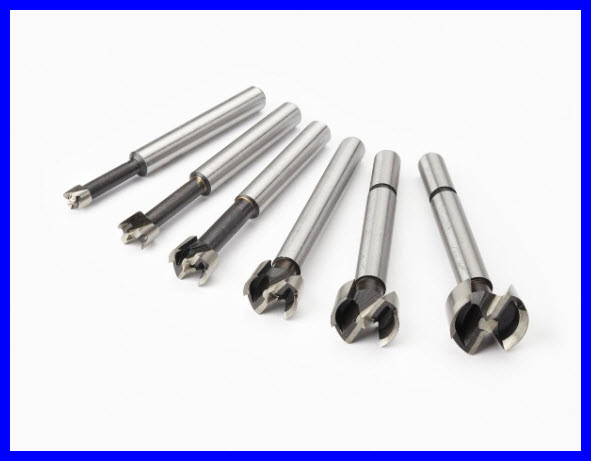

Forstner bits come in many diameters:
