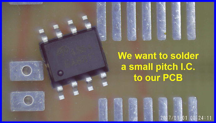

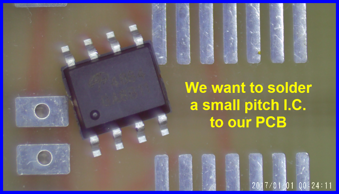

We have all used solder wick to remove excess solder from electronic component leads.
By reversing the process, you can use solder wick to apply a controlled amount of solder to small fine pitch components.
Use a magnetic hold down tool to anchor your component to the PCB.

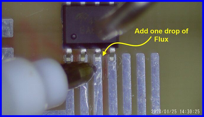

Add a drop of liquid flux to the leads.
