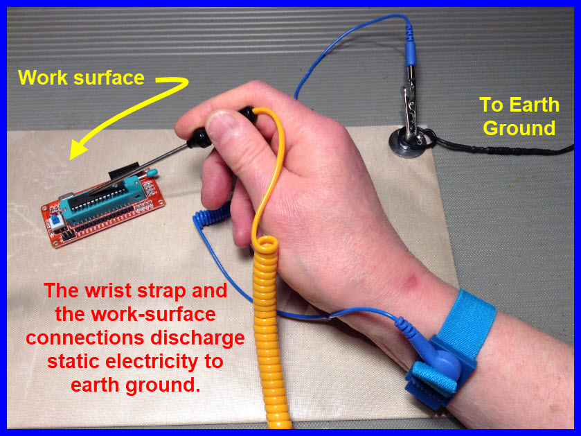

Electronic components can be damaged by static discharge.
Carpets, friction, insulated surfaces, and even body movement can build up high static voltages; this static can destroy your components.
A grounding wrist strap and a ground connection to your work surface discharges static voltages harmlessly to earth ground.

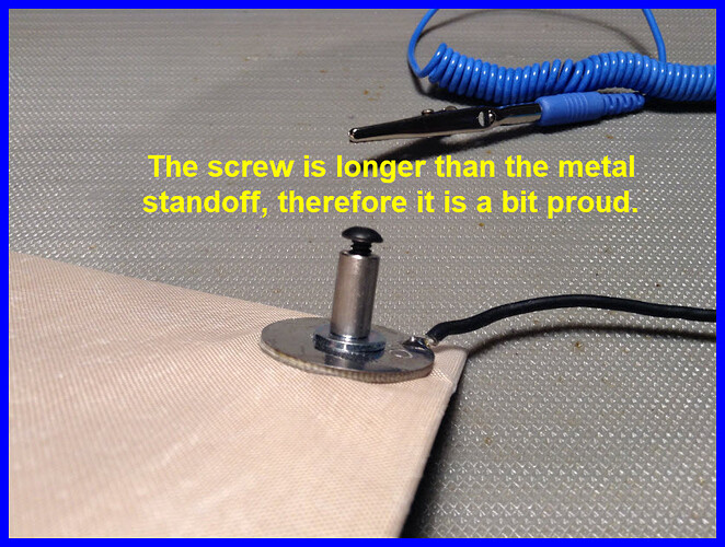

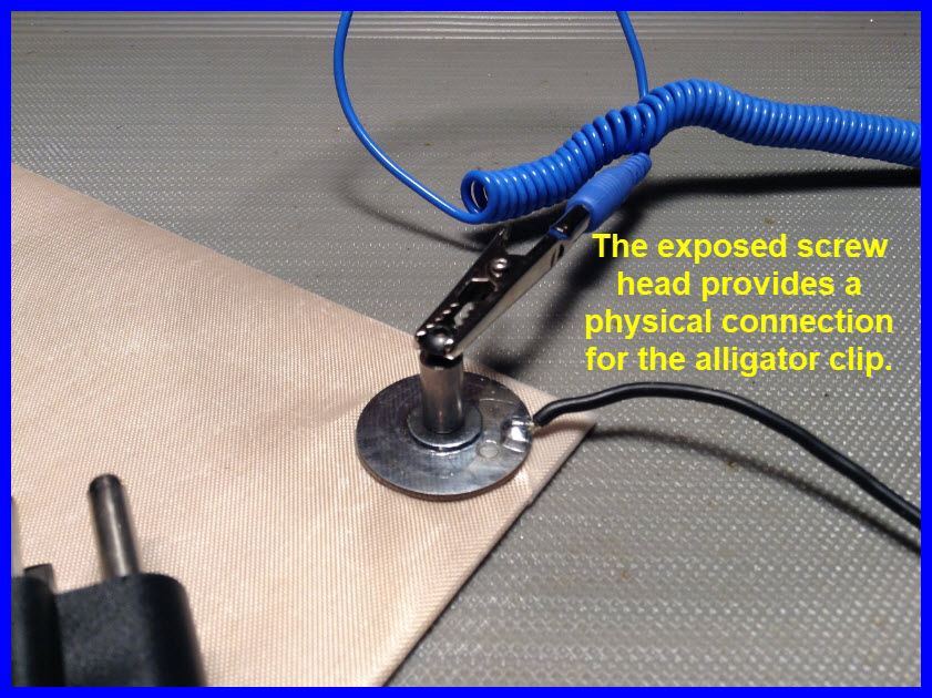

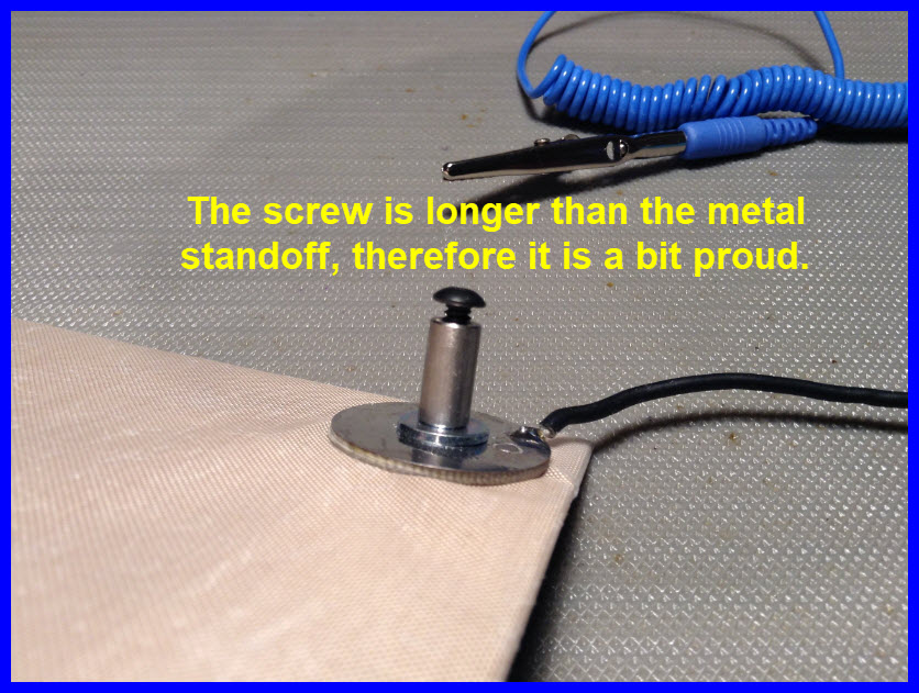

Ground straps often have a high valued series resistance between your skin and the metal alligator clip.
The resistance in the ‘wrist strap’ seen below is 1 mega ohm.
In the images below, the series resistor in the ‘work surface’ earth ground lead is 2.2 mega ohms.
For added safety, my workbench power outlets are on a ground fault circuit.
