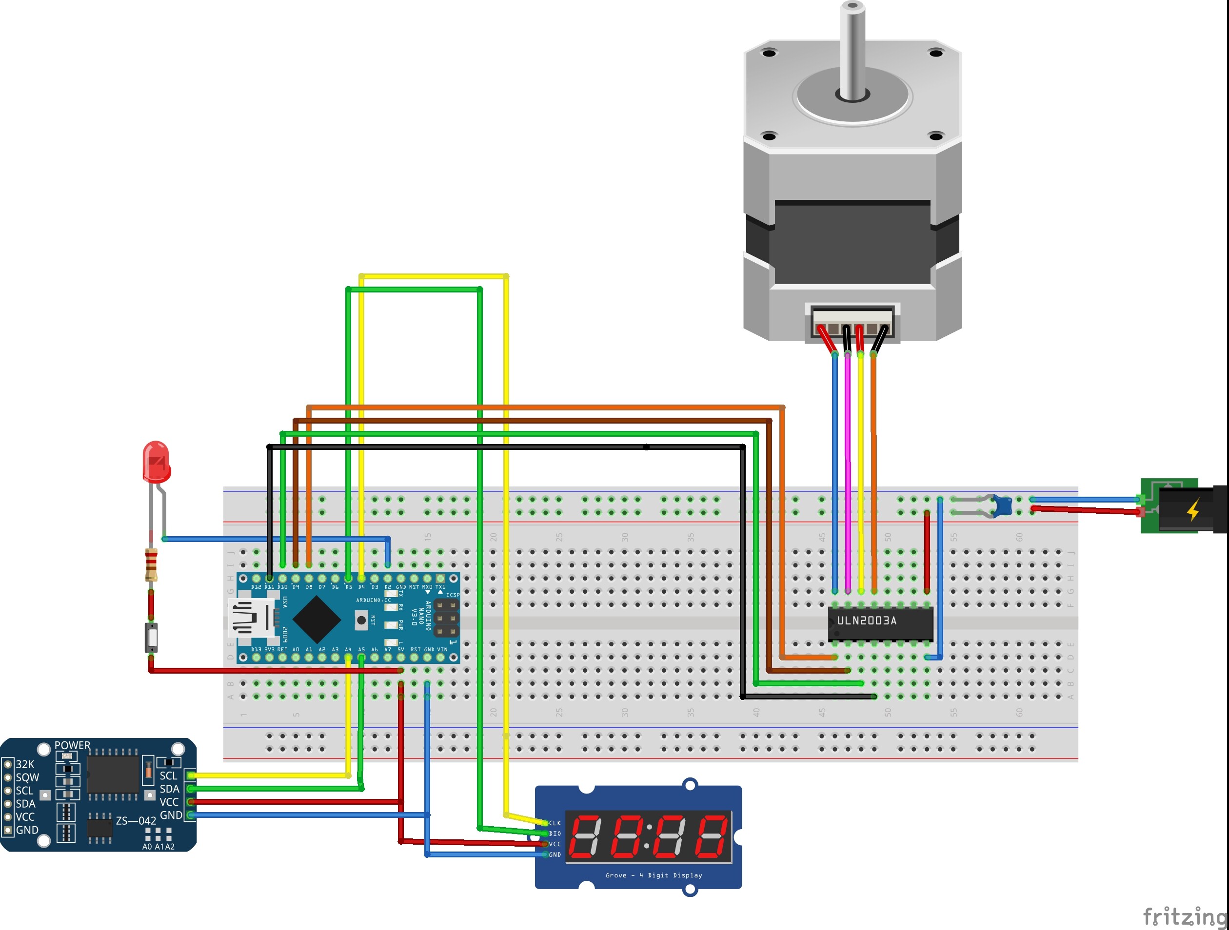

Sounds like your wiring is wrong, post a diagram.
It's wired like below now. Note: the stepper driver board and cap. sensor are not in the Fritzing library so I made a mock-up of these. I use this driver board and this capacitive sensor
Nothing wrong with that I think. I tried powering the display and clock on the same 5V rail, but that didn't work.
I don't see a connection from the driver GND to the Arduino GND, no return path for signals.
Like I said, the stepper driver board is not in Fritzing so I just used the chip itself as mock-up.
It's wired like here, just with an external 5V.
Why should I connect the Arduino GND to the GND of the other power supply?
Electricity flows in a CIRCUIT, you are sending a signal from the Arduino to one of the inputs on the driver, there has to be a return path to the Arduino for the signal, no circuit, no signal seen by the driver.
Funny enough, the circuit does work as initially drawn. But the question was not that the stepper is not working (because it is), the question is how I can share the 5V source with the Arduino, stepper and other peripherals?
As said, connecting the peripherals parallel to the stepper gives them too little volts to function, although the power supply is well-capable of feeding the stepper.
