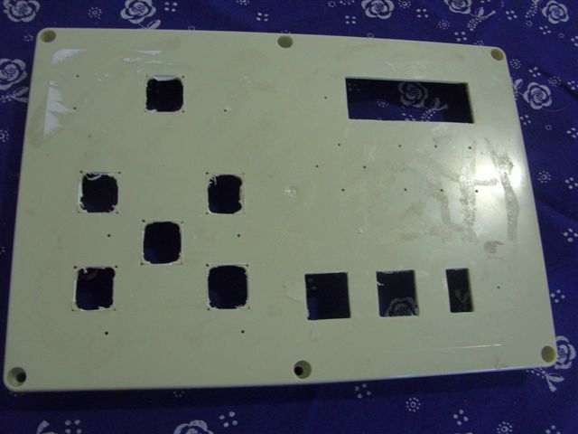

These are all just thoughts as I drill 50 square holes in plastic boxes while all around are enjoying a holiday !

Boffin1:
How do you drill square holes?

" How do you drill square holes? "
Until I can get a punch made -
Slowly :frowning:
I drill a tiny hole in each corner of the rectangle, tape 4 straight edges around the shape, score the plastic with a craft knife, drill some bigger holes in the middle, break out the waste , and then file the edges down to the straight edges.
Then start on the next hole ! Until it looks like this
