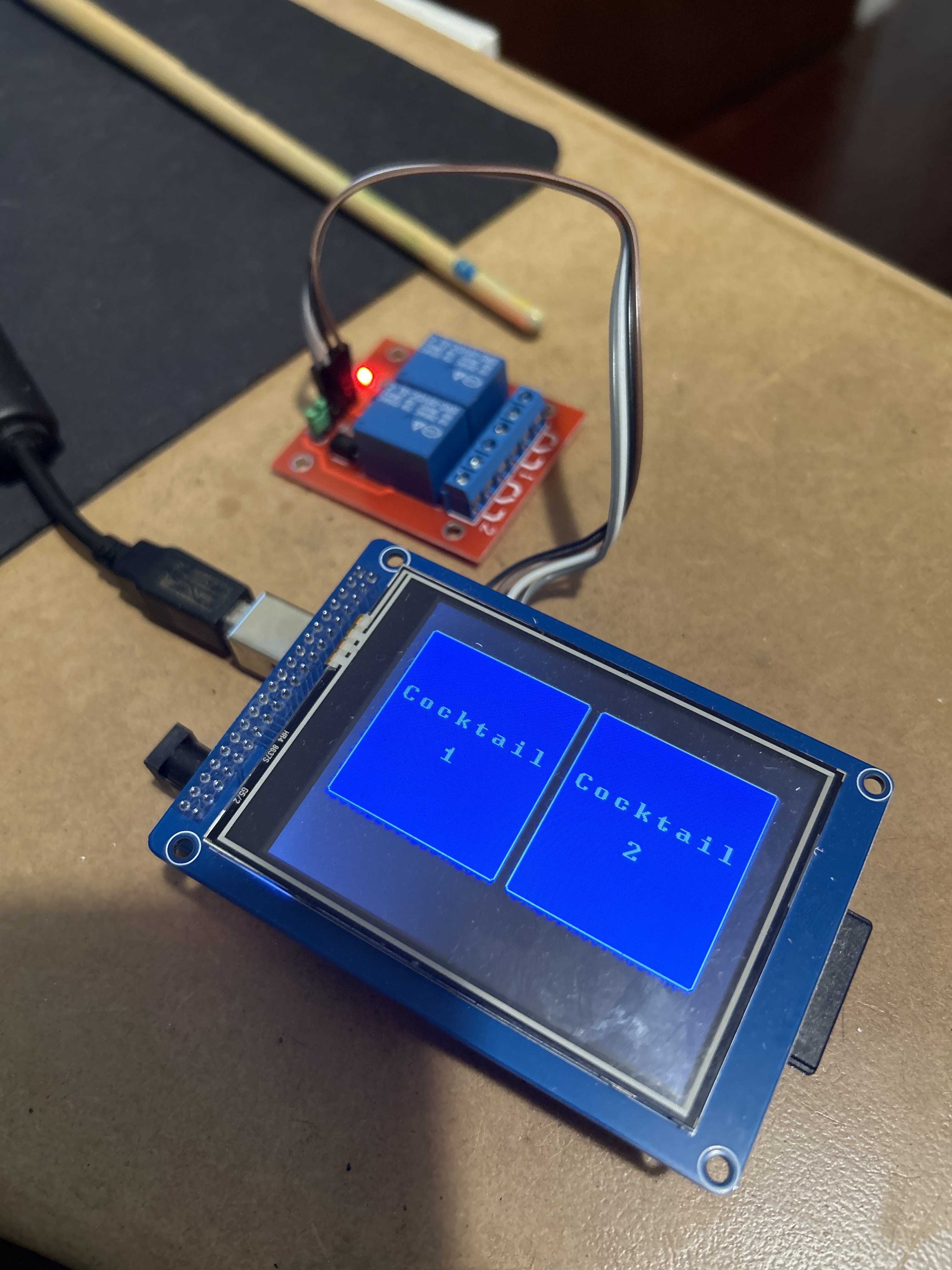

I am in the process of making a robot cocktail maker. The first phase in this is to create the brains behind it. So far have managed to get my touch lCD screen. To work nicely with a relay and plan to use a multi relay setup to open and close a number of valves for the alcohols and juices that will make the cocktail. If you check out the pictures you will see my setup. At the moment I just have two boring buttons that say cocktail one and cocktail 2, but I would like to use images of cocktails as buttons. I tried changing some to code but of course eventually I would run out of space. Does anyone know how I can use images on the SD card at the back as buttons. To get round the small amount of memory that I have on the arduino.
I will post up the code I am using in a reply so you can see where I am up to?
This is the code that I am using

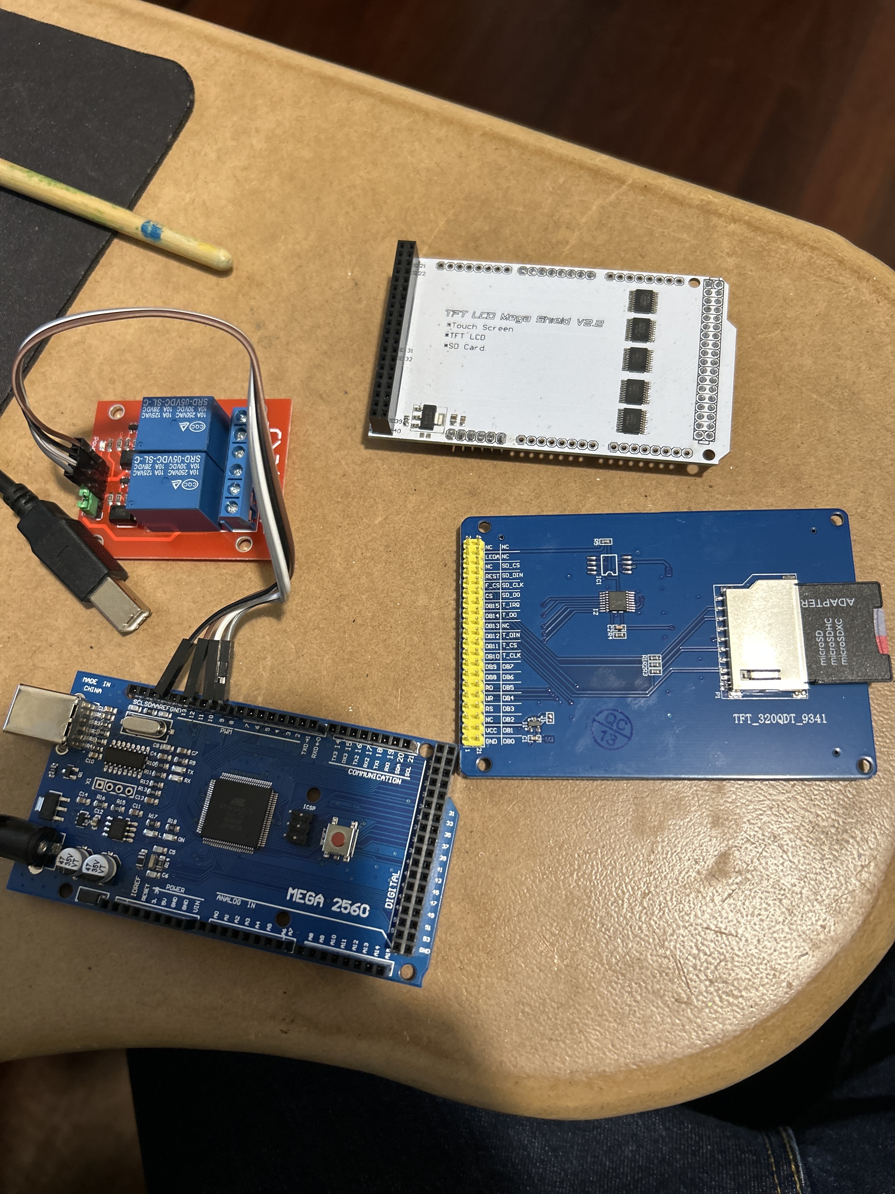

The kit is from Ali express
https://www.aliexpress.com/item/1005004918153220.html?spm=a2g0o.productlist.main.1.6c05Q7YNQ7YN10&algo_pvid=4ab9ad62-fc75-418a-bcd3-07caf6a4af05&algo_exp_id=4ab9ad62-fc75-418a-bcd3-07caf6a4af05-0&pdp_npi=4%40dis%21AUD%215.58%215.58%21%21%213.65%213.65%21%402101e83017183615082283849efdc2%2112000031012824850%21sea%21AU%210%21AB&curPageLogUid=am2peg0mrTbq&utparam-url=scene%3Asearch%7Cquery_from%3A
I have all of the RinkyDink librarys installed UTFT, URtouch, UTF_Buttons, UTFT_SdRaw-1.2.4,UTF_SPIFlash and SdFat.
The TFT screen is an ILI9341

Is that Mega an appropriate choice? Consider something with more memory perhaps. A Teensy or an ESP might do it or you could use a Pi for a gargantuan menu of drinks.
Compared to the cost of a few bottles of liquor, a better microprocessor is pretty cheap.
