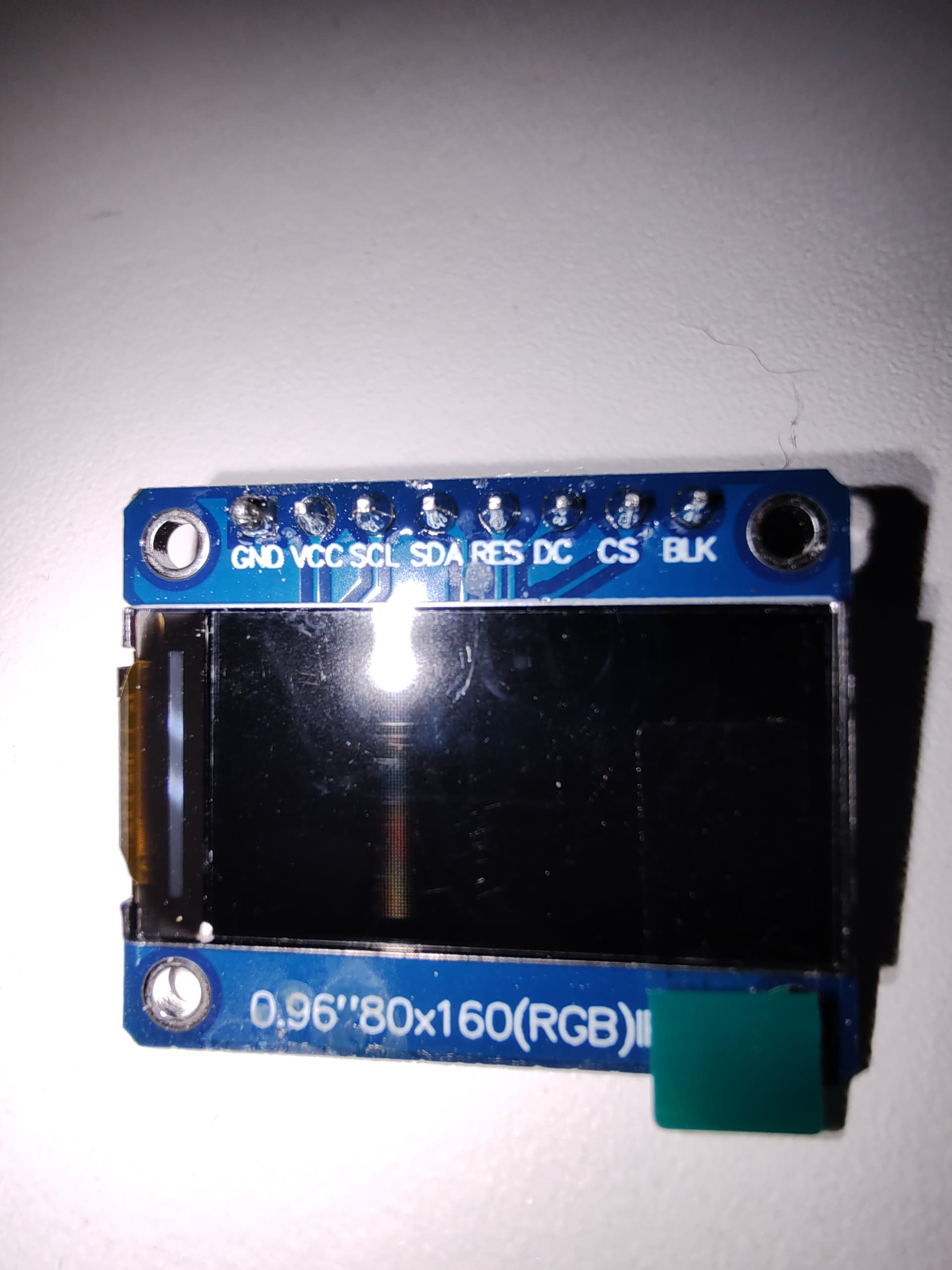

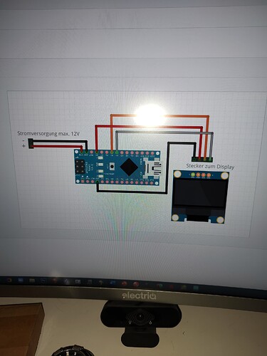

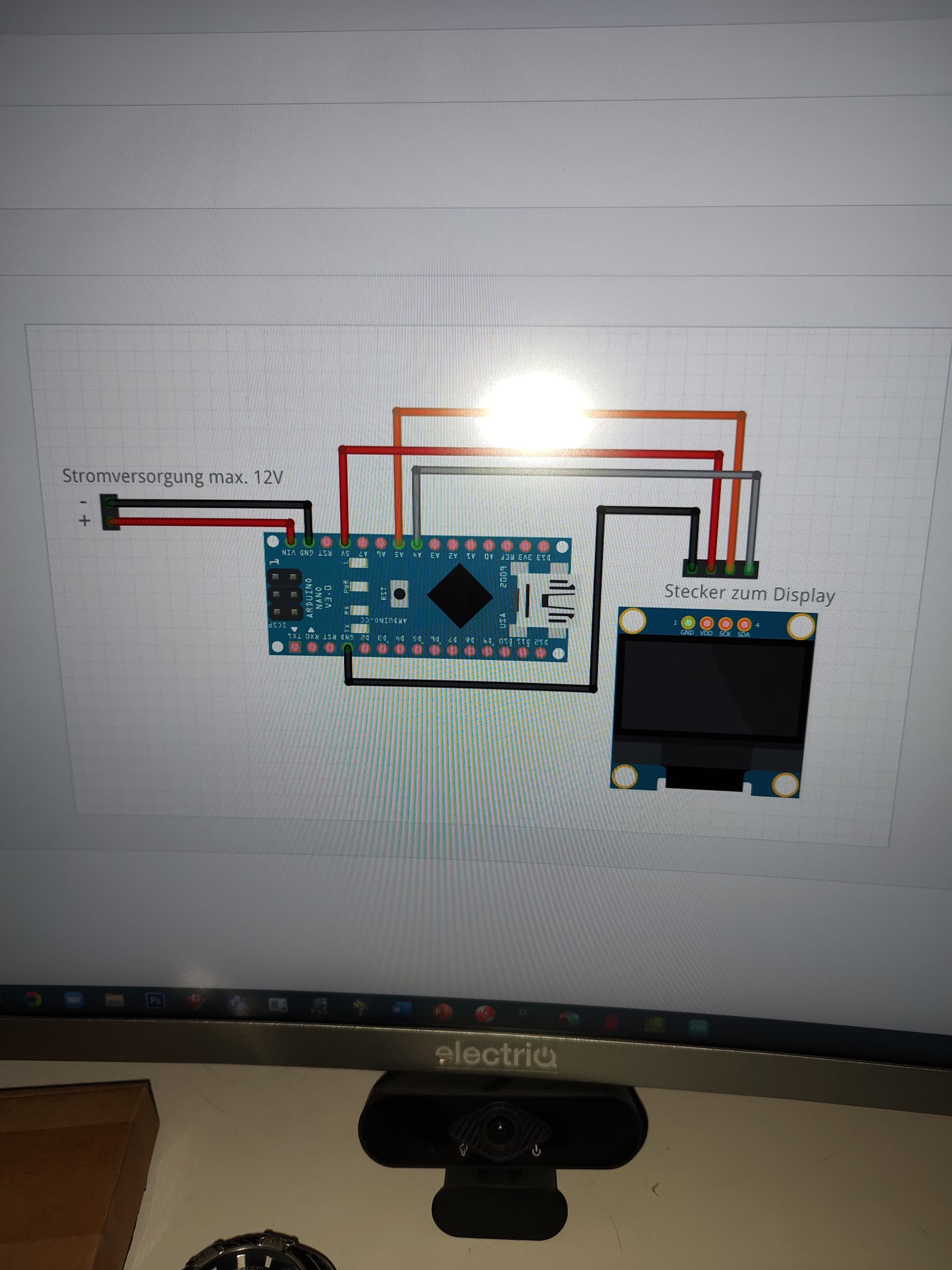

Pics above if the diagram I have been given and the screen I have, I've worked out the 5v , grd, sda but on my screen I don't have a sck pin.
Can I still use this screen or should I grab a different one, I want the display to be in green
SCL is Clock
SDA is Data
The diagram shows sck and sda, it's the sck pin I'm unsure of on this screen
What's the uncertainty?
The display you have in pic 1 is a I2C OLED, while the one showed in pic 2 is a SPI one. Take a look a the difference between these 2 protocols.
PS: The versions of the display in pic2 that are sold here in Brazil operates in 3.3V. Nano is a 5V device. Check your hardware specs if you don´t want to have other problems...

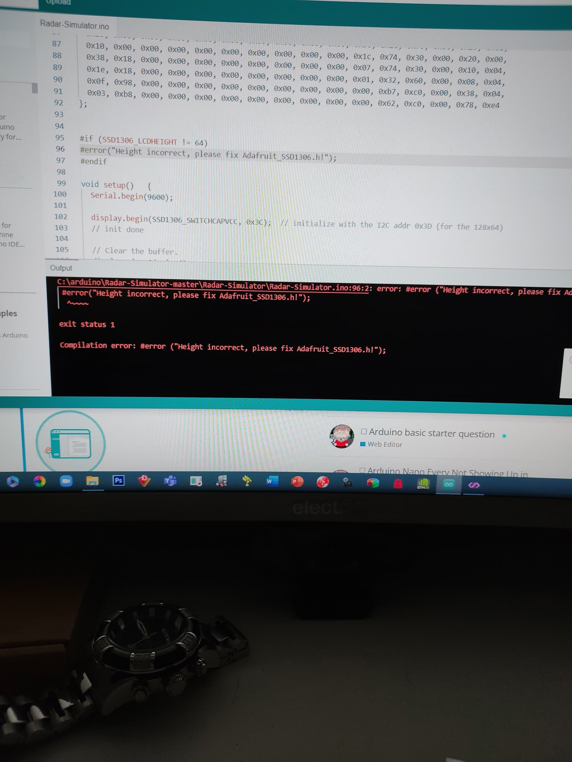

Ok so I've swapped to the same screen as used in the diagram but now but now I get this error
If you google the two types of display you will find connection diagrams for both types , libraries with example code .
Mr Google really is helpful , I answer most questions on here by googling them ….
For example
i've tried google, it gives a solution by changing some lines of code, but the example they give is different to my code lines
And…..does theirs run ?
You need to post your code , is it something you copied out or did you write it ??
The examples allow you to learn how to use the display .
BTW - that’s not a green display.
right it was a link i was sent, i've copied the code and pasted it into ide, as far as i'm aware,
theirs works.

The constructor for the Adafruit_SSD-1306 library assumes the display size based on the I2C address of the display. This is not always correct for the generic brand displays many of us use. Adafruit has added a different form of the constructor that allows you to specify the array dimensions, I’m not where I can look that up on a computer right now, you can either look in the library examples, or there should be a reference webpage for the library if you google it.
That explains alot, someone said I need to remove a line, someone else said I need to change a line, Google said I need to change line 73 to 75 in one of the files, but I checked my file and it was different to the one Google were showing

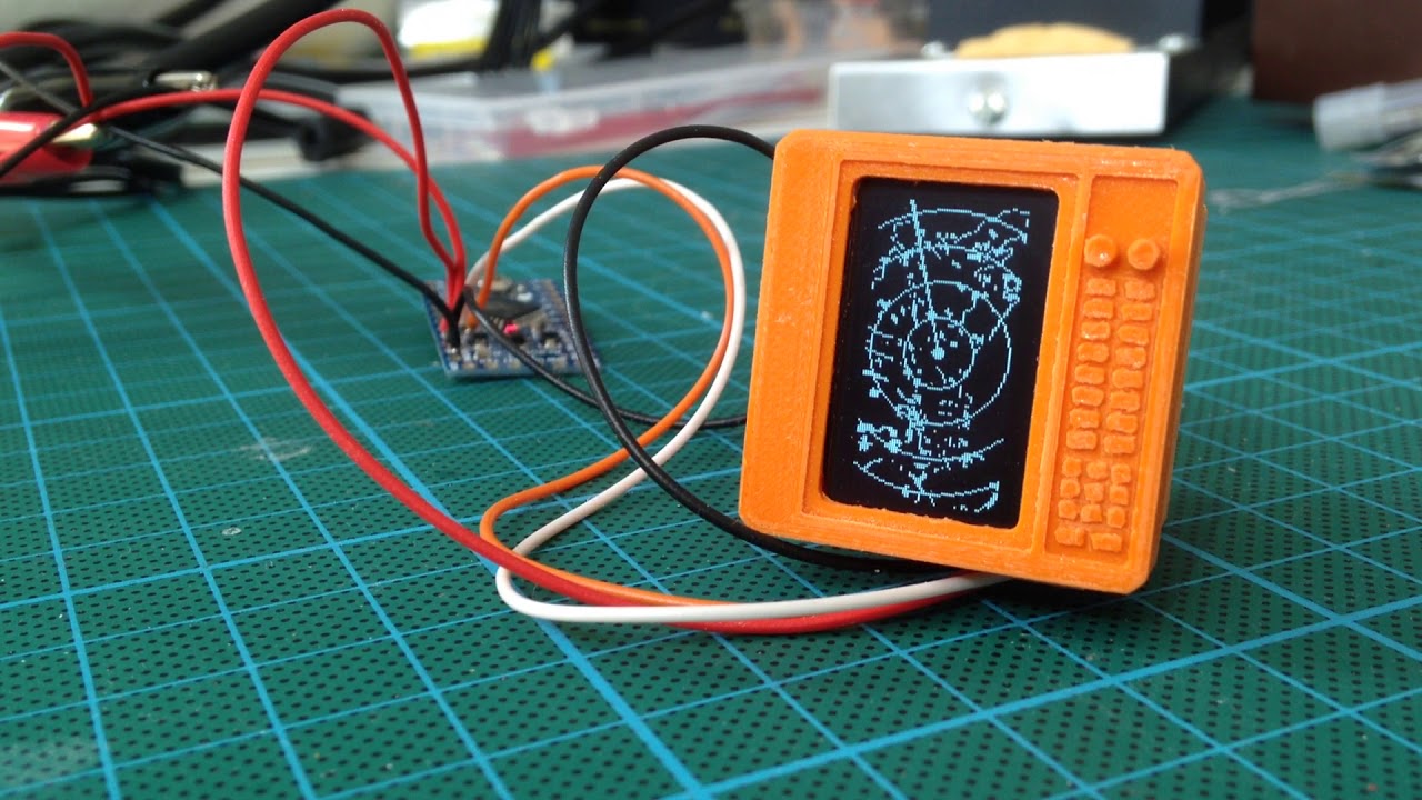

What should the display look like when it is running ? I imagine that it will be a circle with a line along the radius from the centre to the edge of the circle moving around the circle. Is that right ?
Thanks for the picture
That is quite a complicated display. The video seems to show that nothing on the display changes apart from the radius bar sweeping round the circle which makes things simpler
I am sure that the details are somewhere in this topic but please remind me which Arduino board you have and which display you have to avoid me having to search for it
It's an Arduino nano, I've managed to get it running but it's really slow
