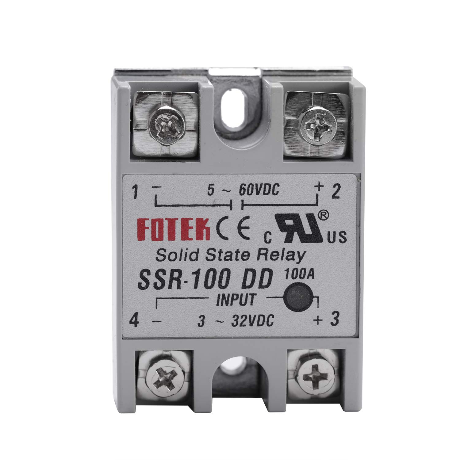

There are multiple SSR that control DC. There is a MOSFET in it and mostly a led input.
CN024D05
I have switched DC with relays for many years, you just have to abide by there specifications. You need to pick the correct device to succeed. Mechanical relays do not normally care if it is AC or DC. When switching DC with electronics it is dependent on the design and selection of the components used to accomplish the solution.
This will switch DC. Isolated MOSFET MOS Tube FET Module Replacement Relay 100V 9.4A 30V 161A 40V 50A Board Module, See my link in post #2 for more details. I have used several for loads upto 4 amps.
There are several variations of these modules. The pin inputs are for the control signal to the opto isolator. maybe 10mA or so. 2A is well within the ratings of these devices as is 24V.

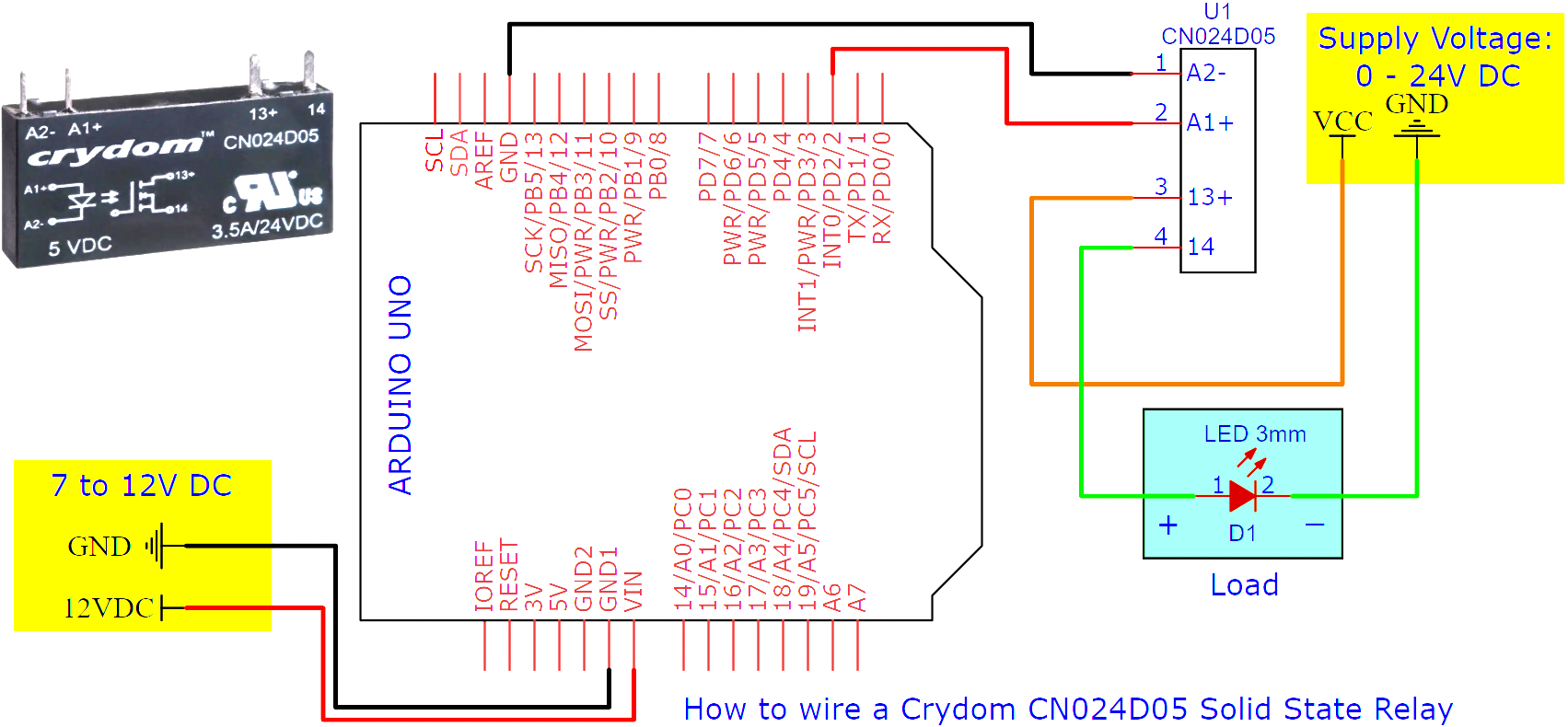

Thanks for the recommendation. I went with the Crydom CN024D05 relay. I had a senior moment and couldn't get the relay to function correctly at first. My load was always powered on! This was regardless of the A1 A2 pins, as nothing was connected to them. I looked up freewheel diodes, RC snubber circuits, and made myself even more confused. One search term revealed a guy who suggested that he wired the load backwards! So, for the next poor soul that needs a "How'd the other guys do it?" here's my working diagram:

You don't need a flywheel diode or a snubber network, the SSR is just an opto-solated mosfet
I tend to use this method, even when building with discrete components. Nothing like good isolation to protect the MPU
Info: the flywheel diode and snubber networks are used on inductive loads
