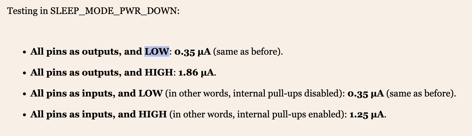

I know it's the common assumption that pins should not be left floating (i.e. - in INPUT mode). But the tests I've done actually measuring power-down sleep current on the 328P don't show any difference between INPUT, OUTPUT Low, and OUTPUT High if nothing is connected to the pins. I guess to be accurate I should say that any difference that may exist is some fraction of 1uA.
According to Gammon here are the details when in SLEEP_MODE_PWR_DOWN
I haven't found info for normal mode but my assumption is that the OUTPUT LOW current will be the same, 0.35UA. I can see I will have to get one of those Current Ranger's.

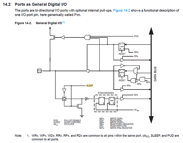

  • Atmel datasheet:
13.2.6 Unconnected Pins
If some pins are unused, it is recommended to ensure that these pins have a defined level. Even though most of the digital inputs are disabled in the deep sleep modes as described above, floating inputs should be avoided to reduce current consumption in all other modes where the digital inputs are enabled (Reset, Active mode and Idle mode).
The simplest method to ensure a defined level of an unused pin, is to enable the internal pull-up. In this case, the pull-up will be disabled during reset. If low power consumption during reset is important, it is recommended to use an external pull-up or pull-down. Connecting unused pins directly to VCC or GND is not recommended, since this may cause excessive currents if the pin is accidentally configured as an output.
Pins can float to intermediate levels ("illegal" as digital levels) causing both output mosfets to be partially biased into their active regions, significantly increasing current consumption.
Detail: here's the schematic for a CMOS inverter:
If Vin is at Vdd, the bottom N-channel MOSFET should be on (Vgs = Vdd) and the P-channel MOSFET should be off. If Vin is at GND potential, the opposite happens. If Vin is, say, halfway between VDD and GND, it's possible that both mosfets are "slightly on", giving a direct path between Vdd and GND; if "slightly" is small, you get more current consumption than you would otherwise. If it's larger, you can potentially burn out one or both mosfets.

See post #4. If you want to disagree with Gammon, go for it, me I take his word as gospel. https://www.gammon.com.au/power
The note about sleep mode? How did I disagree with that?
from the 328P datasheet --- note that we don't read in Sleep Mode
18.2.4. Reading the Pin Value
Independent of the setting of Data Direction bit DDxn, the port pin can be read through the PINxn
Register bit. As shown in Ports as General Digital I/O, the PINxn Register bit and the preceding latch
constitute a synchronizer. This is needed to avoid metastability if the physical pin changes value near the
edge of the internal clock, but it also introduces a delay. The following figure shows a timing diagram of
the synchronization when reading an externally applied pin value. The maximum and minimum
propagation delays are denoted tpd,max and tpd,min respectively.
Figure 18-3. Synchronization when Reading an Externally Applied Pin value.
--and then there's a timing diagram showing synch and read.
