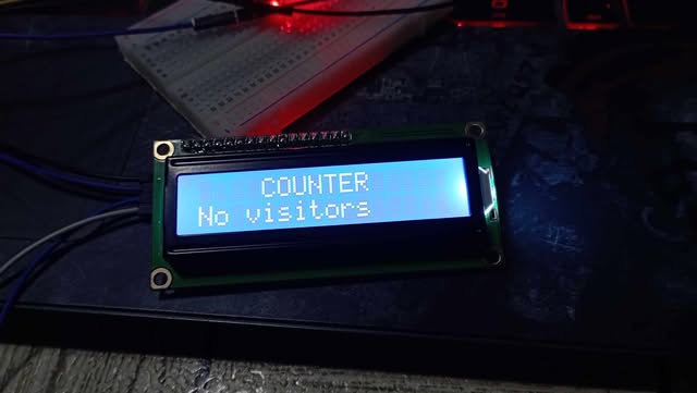

Showing different text when the Infrared sensor detected a motion
I'm having trouble researching a video that would solve my problem, but it didn't. I'm searching for a tutorial that when an Infrared Sensor detected a motion a new text will pop up at the 16x2 lcd, it's just like counting but it will show a different text.

Which Arduino board do you have ? I have an Arduino Uno
What type of LCD do you have ? The LCD that i have is 16x2 I2C
Can you detect a motion and print a message to the Serial monitor ? I couldn't. I wanted a code that a text1 will show at start and when the Infrared Sensor detected a motion a text2 will show but the text1 will clear

This is doing a couple things at the same time:
  • Change detection on the sensor
  • Updating the screen
Look into the built-in state change detection example, and consider put the screen updating in the counting part.
Well, videos aren't necessarily your best option, because there are so many possible projects out there that the likelihood of finding a video worth its salt that does what you exactly want is pretty low.
That means you'll spend a lot of time going down dead end paths that lead to frustration.
What you're after is a finite state machine.
Every time your sensor detects motion, you will increment a variable of the appropriate size by one. A byte is good enough, 0-255 gives you 256 states on the machine, where each state points to a different phrase on the LCD screen.
If i was making your specific project, I would reserve 0 for the default state, as in showing nothing and I would use state 255 as the state where you clear the LCD screen and set up the cursor for states 1 to the number of phrases you have that just prints the stuff you want, but that's just how I would approach it.
To implement a finite state machine, you'll want to look at the example sketches StateChangeDetection and SwitchCase where State change detection uses a hardware event to drive a state variable defined in your code, and switch/case is the general control structure to implement the state machine (as opposed to if/else if/else).

this is the thing that i wanted to happen but i dont want it to be a counter but it will just show a new text
this is just a counter code that i got it from youtube
