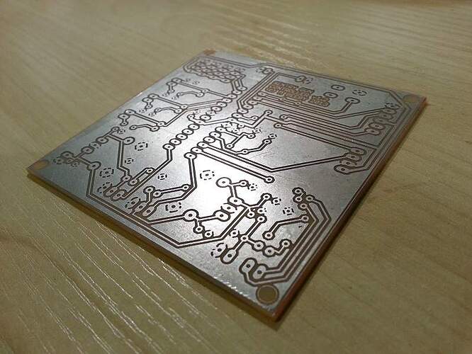

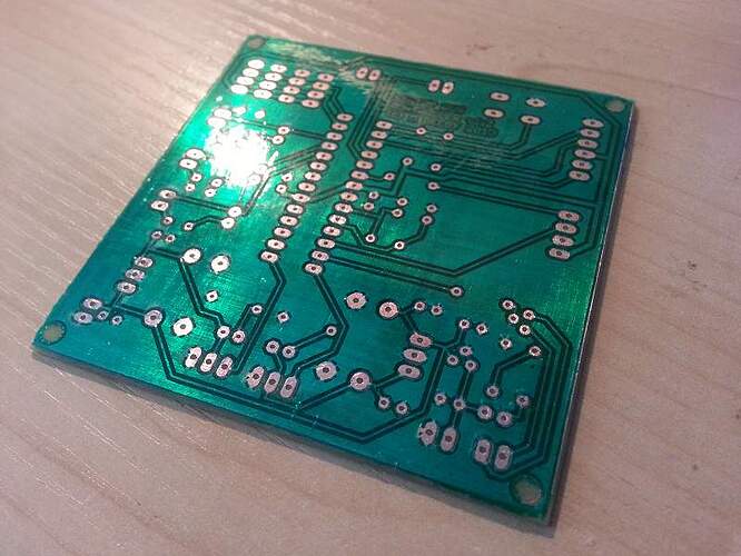

You can get decent results with toner transfer and home brew. See the example images of one of mine. I made a bit of an error with the silkscreen by using my toner transfer laminator (too hot) instead of normal temperature one, but it's still pretty good.
I'll do anything where I need a quick prototype or just a few reasonably simple boards, but I use Elecrow for pro-fab boards at about £10 for 10 off 50x50 or £20 for 10 off 100x100 double sided, any colour solder mask.
I did try to use a home iron for a while... which only convinced me why I wanted a heat laminator. Results with an iron are OK, but I would not call it a consistently good solution. Lot's of variables to help it go wrong.

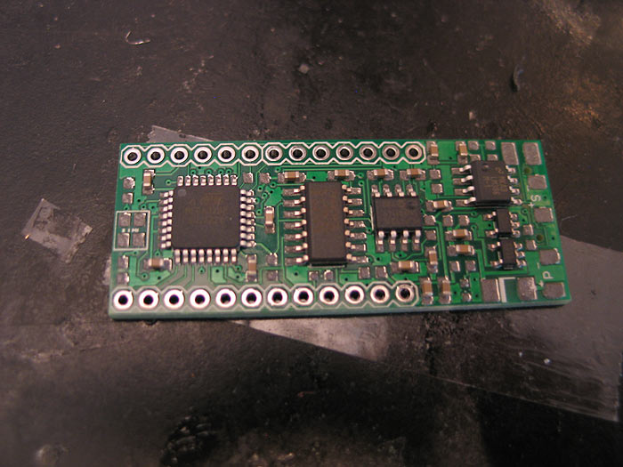

My current approach is ordering PCBs from china for CHEAP.. (or in a pinch still the DIY toner transfer method, in which I have done double sides DIY boards before)...
and using a solder paste stencil/mask.. and solder paste to add my components..
add in my $17 wal-mart toaster oven for re-flowing.. all done.
I have just added a Silhouette Cameo (vinyl/paper cutter) to my arsenal.. so I can now make my own solder paste masks/stencils.. and stop paying $30 a pop for them!
they turn out great.. better/same quality I have seen from Pololu and ohararp (although the later are pretty good too!)
this is down to 0603 components & QTFP ATmega328P-Au chips..
I have even done (not sure of package name, but SMD accelerometers and amps chips too)

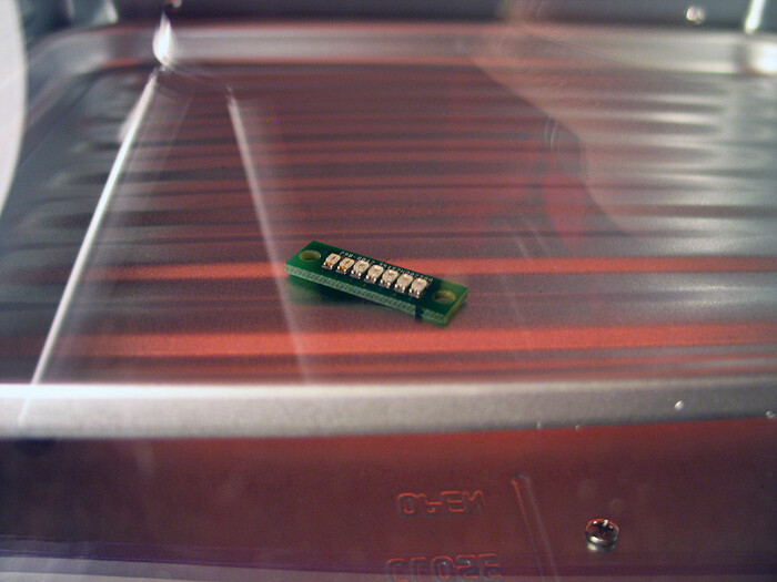

DIY pcb.. hand applied some solder paste (no need for stencil on this little junk!) :slight_smile:
popped into toaster oven for a few minutes:

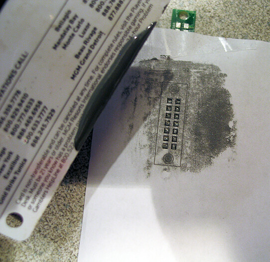

Before I got the Silhouette Cameo..
I would even use paper and an exacto knife to make a paste mask/stencil. (only for small/simple boards of course!)

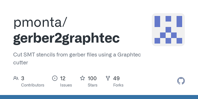

this takes the installation of several other programs/applications..
its more or less a Phython script that that takes your gerbfile file and converts it using a .py script into coords to send to the Cameo.... it more or less re-home/re-aligns the blade after each cut to make them all correct alignment/precise.. takes a long time to make one stencil (originally...read more)
if you are Windows its a bit more...Linux/Mac I guess it much easier by default.. (not sure.. Im a windows sap still!) lol..
anyways.. you'll need to download and install the following:
this is the 'magic script' right here:
download gerber2graphtec from:
matter of fact you can follow my failures and success here on Dangerous Prototypes forum:
it will outline everything way better than i can again.. lol..
once you get everything installed..
there were some NEW updates you'll want to use:
1.) the author made a GUI that makes things MUCH easier..
2.) another member created an 'optimized' .py file to replace the OG one in the gerbertographtec directory...
it makes the stencils cut WAY faster.. minutes rather than hours (which is how long some stencils would take with original script)
just read through it to the end so you can see all the changes and results posted!
